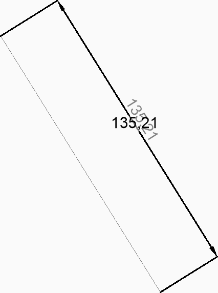

- Angle
- Specifies the angle of the dimension text. A value of 0 aligns the dimension text with the dimension line. Any other value rotates the dimension text relative to the x-axis of the current UCS.

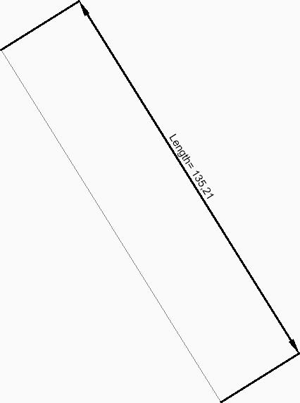

- Text
- Allows you to enter text to override the default dimension text which includes the measured length of the dimension. You can use two angle brackets <> to display the measured length of the dimension in addition to other text.

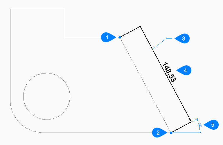

- Origin of first extension line
- Origin of second extension line
- Location of dimension line
- Rotated dimension
- Angle of dimension line

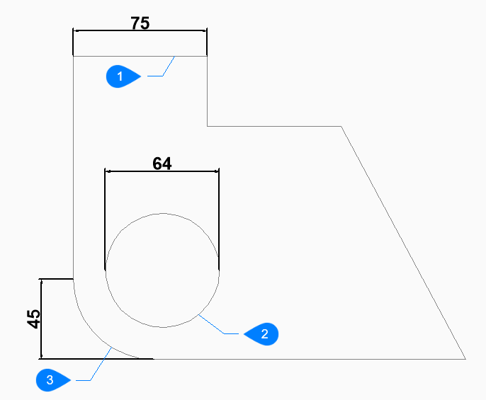

- Select entity
- Allows you to select an entity (line, polyline segment, arc, or circle) to dimension.
When selecting a line, the endpoints of the line are used for the extension origins.
When selecting an arc, the endpoints of the arc are used for the extension origins. When selecting a circle, the quadrants of the circle are used for the extension origins.
- Line entity
- Circle entity
- Arc entity
