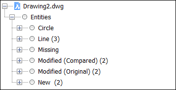

You can see a list of differences in the Structure panel as well. Open it with the STRUCTUREPANEL command and make sure that the Default CST configuration file is loaded. Expand the Comparison node in the Structure panel.
Note: The ENDCOMPARE command unloads the comparison drawing.
