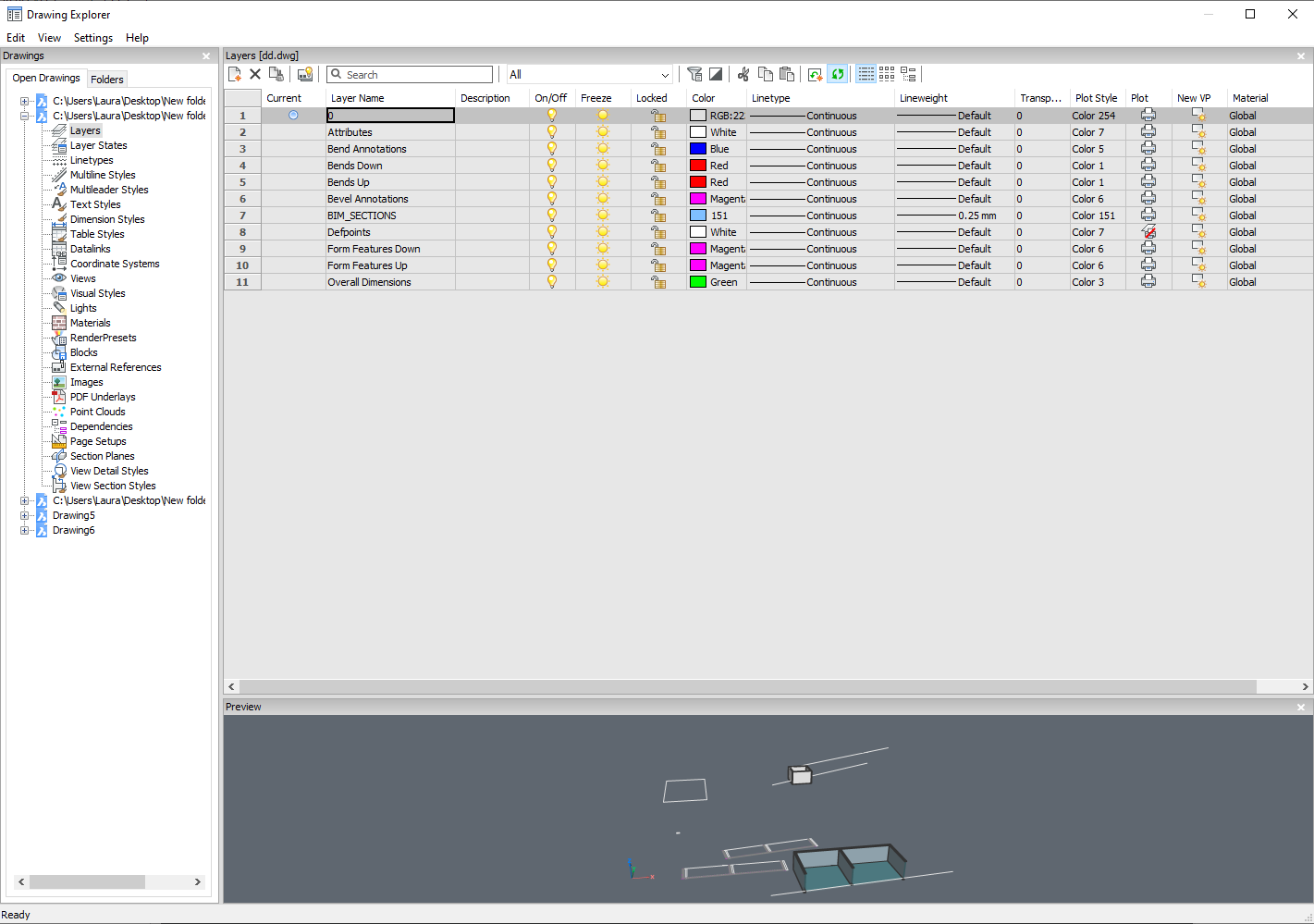

EXPLAYERS command
Opens the Drawing Explorer dialog box with Layers selected.
Opens the Drawing Explorer dialog box with Layers category selected to view and modify layers in the current drawing.
Note: When you open the Drawing Explorer - Layers dialog when in paper space, additional columns are displayed: VP Freeze, VP Color, VP Linetype, VP Lineweight, VP Transparency, and VP Plot Style, where VP is short for viewport.
Note: By default, these columns match the corresponding model space settings, but viewport layer properties can be set differently for each layout and for each paper space viewport. If the SHOWLAYERUSAGE variable is On, then the Layer Usage icons indicates whether viewport settings for the current layout and paper space viewport are different from model space settings:
: current layer with viewport overrides. -
: layer with viewport overrides. -
: empty layer with viewport overrides.
Note: If no paper space viewport is active, then the settings apply to entities in the current layout. If a viewport is active, then viewport settings override the BYLAYER properties in the current viewport.
Note: The VP Freeze setting controls the Thaw/Freeze status of layers for the current layout tab or viewport. The New VP setting specifies the default Thaw/Freeze status of layers for new layout viewports.
