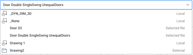

Name
Specifies the name of the block to insert, whose definition exists in the drawing, or the name of the file to insert as a block.
Note: Click the drop-down button to display the available blocks. It shows internal and external block types, with icons indicating each block's type.

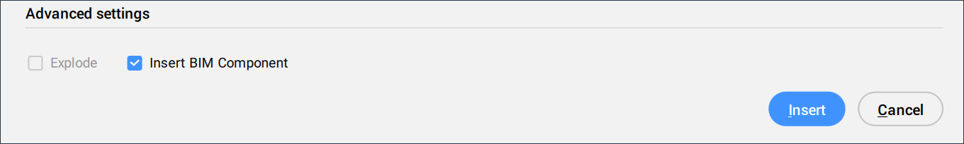

Insert BIM Component
Determines whether to insert the block as a BIM Component.
Note:
  • The Insert BIM Component option is available only if an external BIM Block is selected for insertion.
  • This option is available for a BricsCAD BIM license. If you are using a BricsCAD Pro or a BricsCAD Mechanical license, the option becomes Insert feature.

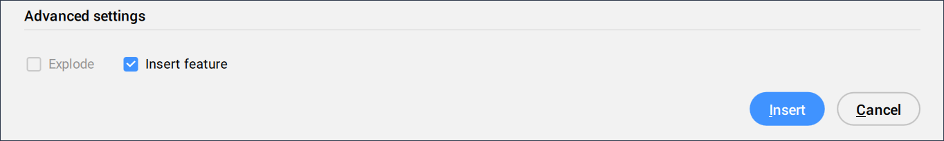

Insert feature
Determines whether to insert the block as feature.
Note:
  • The Insert feature option is available if an external mechanical block is selected for insertion.
  • BricsCAD Pro or higher is required for this option.

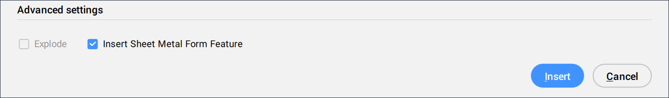

Insert Sheet Metal Form Feature
Determines whether to insert the block as a sheet metal form feature.
Note:
  • The Insert Sheet Metal Form Feature option is available only if a sheet metal form feature block is selected for insertion and the Model Space contains SM flanges.
  • This option is available for a BricsCAD Pro license or higher.

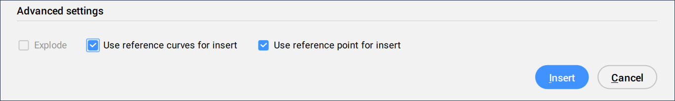

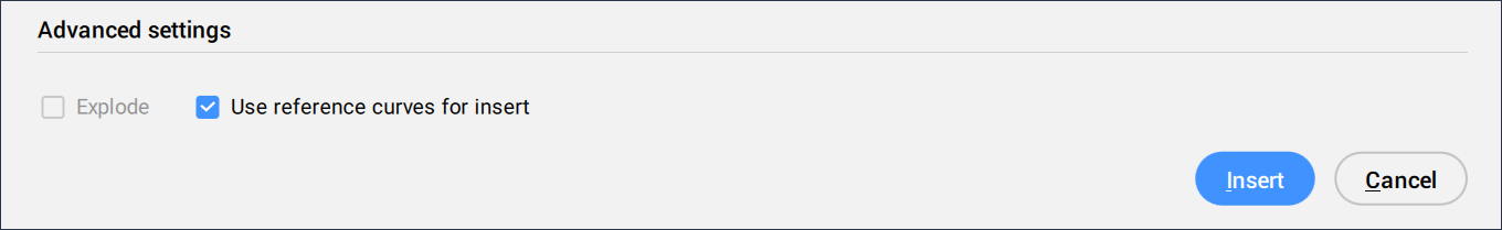

Use reference curves for insert
Determines whether reference curves are used for insert.
Note:
  • The Use reference curves for insert option is only available if the selected drawing contains reference curves. See also the Fuzzy insert guided workflow article.
Use reference point for insert
Determines whether a reference point is used for insert.
Note:
  • The Use reference point for insert option is only available if the selected DWG file contains a detail with guide curves. Details with guide curves can be created using the COPYGUIDED and MOVEGUIDED commands.
  • It is available only when the Use reference curves for insert option is activated. Otherwise, the option becomes gray out.
