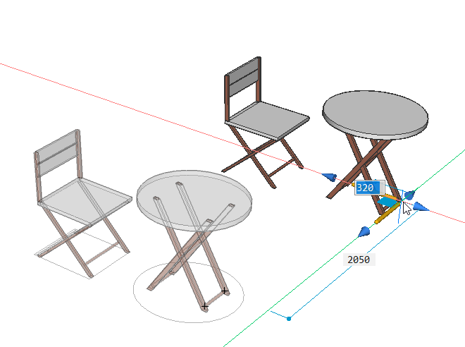

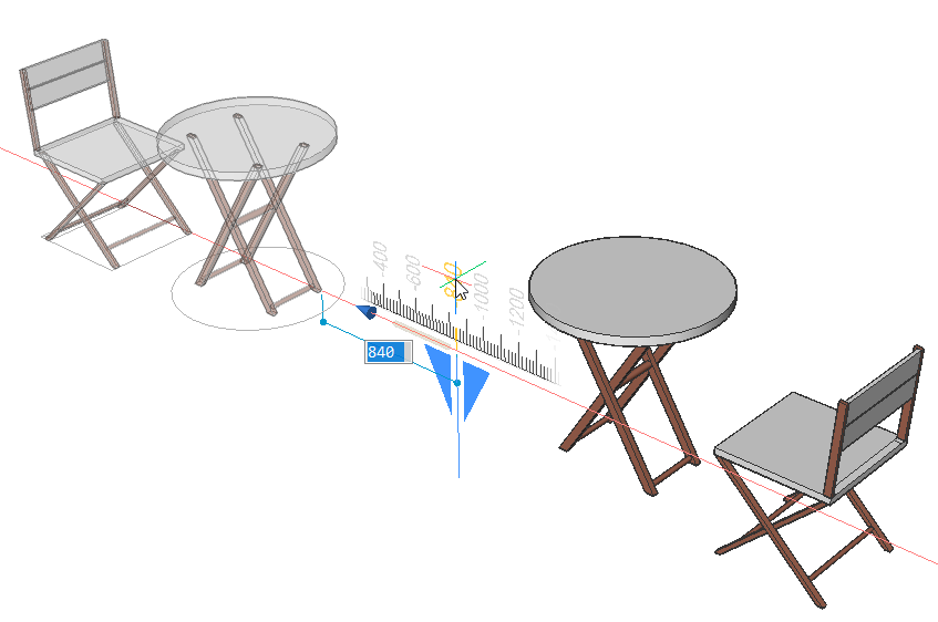

Options within the command
- Select an axis
- Moves the selection of entities along the selected axis.

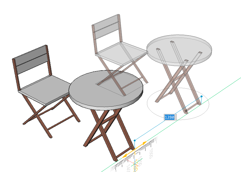

- Select a plane
- Moves the selection of entities in the selected plane.

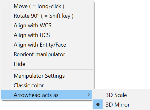

- Select an arrowhead
- Mirrors or scales the selection. By right-clicking when hovering over the manipulator widget, a contexts menu with other options displays. Here, the function of an arrowhead can be changed between 3D mirror and 3D scale.

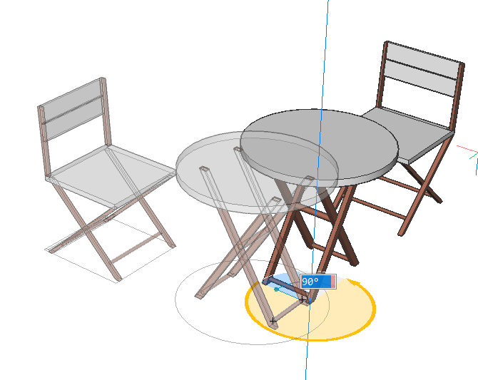

- Select a rotation arc
- Rotates the selection around one of the manipulator axes. Enter the rotation angle value or specify by clicking on a point in the drawing.

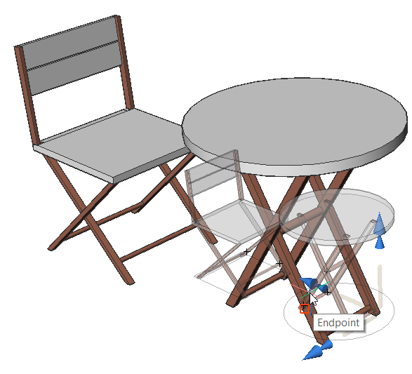

- Select the anchor handle
- If MANIPULATORHANDLE = 0: Moves the manipulator. Specify a point to relocate.
- If MANIPULATORHANDLE = 1: Moves the selected entities unrestrictedly.
Long-click the manipulator handle and move it to a new location.
