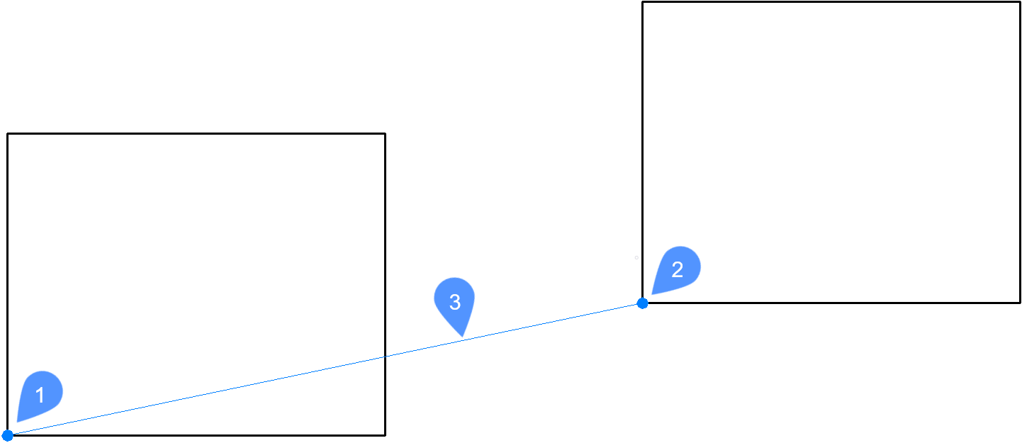

Moves entities by specifying the starting point and the destination.
  1. Base point
  2. Second point
  3. Displacement distance
Options within the command
Displacement
Specify the displacement vector (the distance at which to position the copy). ‘Vector’ means that you specify the distance and angle at the same time.
