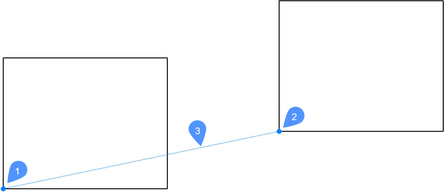

Moves entities by specifying the starting point and the destination.
- Base point
- Second point
- Displacement distance
Options within the command
- Displacement
- Specify the displacement vector (the distance at which to position the copy). ‘Vector’ means that you specify the distance and angle at the same time.
