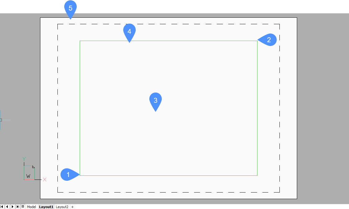

Specifies the first and the opposite corners to create a rectangular viewport.
- First corner
- Opposite corner
- Viewport
- Viewport border
- Paper space (Layout)
