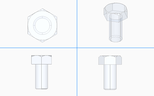

- 2 - std. engineering
- Creates 4 viewports preset to top, front, right and south-east isometric viewpoints.
