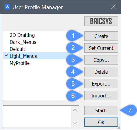

Opens the User Profile Manager dialog box to create, copy, delete, import and export user profiles.
  1. Create
  2. Set Current
  3. Copy...
  4. Delete
  5. Export...
  6. Import...
  7. Start

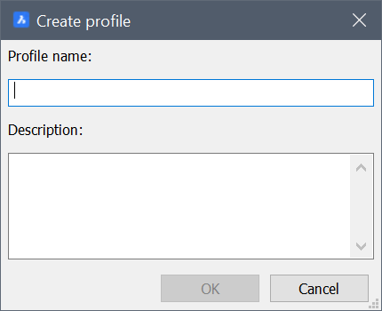

Create
Allows you to create a new profile, using built-in default settings. The Create profile dialog box displays:
Profile name
Allows you to type a name for the new profile.
(Optional) Allows you to type a description for the new profile.
Set Current
Sets the selected profile as the current profile.
Note:
  • You can also double click a profile to set it current.
  • The current profile is marked in the list with a check mark.

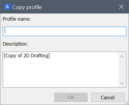

Copy
Creates a new profile as a copy of an existing profile. The Copy profile dialog box displays:
Delete
Deletes the selected profile.
Note: Deleting the current profile is not possible. When trying to do so, a dialog box displays that allows to reset all settings to factory defaults.
Export...
Exports the selected profile to an .arg (profile file) or .reg (registry file) to a specified folder.
Note: Exporting and importing a profile allows you to migrate user preferences from one computer to another.
Import...
Imports saved profiles.
Start
Starts a BricsCAD session using the selected profile.
Note:
  • This option is only available when the command is launched when executing profilemanager_app.exe in the BricsCAD installation folder. By default, the path is: C:\Program Files\Bricsys\BricsCAD V27 en_US.
  • If the SINGLETONMODE preference variable is set to On, it is not possible to have multiple BricsCAD sessions open simultaneously.
