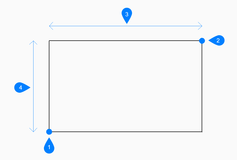

- Select first corner of rectangle
- Allows you to begin creating a rectangle by specifying the first corner of a rectangle.
- Other corner of rectangle
- Specifies the opposite corner of the rectangle. The rectangle is drawn parallel to the X and Y axes.

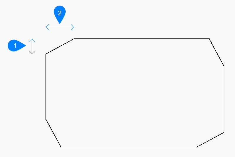

- Chamfer
- Specifies the first and second chamfer distance to use for all rectangles.
- First chamfer distance
- Second chamfer distance
- turn chamfer Off
- Turns Off the Chamfer option.
- use Default setting
- Uses the default settings for chamfer, specified by the CHAMFERA, CHAMFERB, CHAMFERC, CHAMFERD, CHAMMODE system variables.

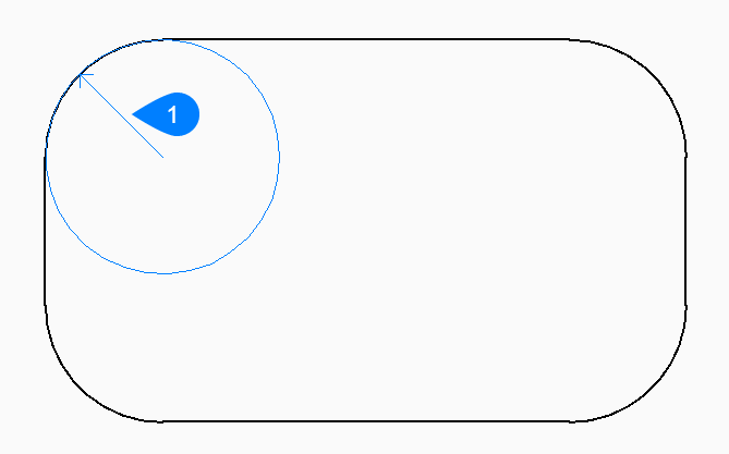

- Fillet
- Specifies the fillet distance to use for all rectangles.
- Fillet radius
- turn fillet Off
- Turns Off the Fillet option.
- Uses the default setting for fillet, specified by the FILLETRAD system variable.

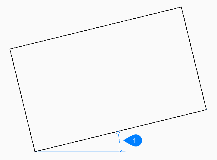

- Rotated
- Creates a rectangle by specifying two corners and the rotation angle.
- Rotation angle
