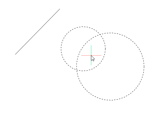

Previous selection
Add the entities from the previous selection to the current select set.
Last entity in drawing
Adds the last entity drawn to the selection set.

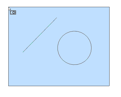

inside Window
Selects all entities that are entirely inside a rectangular selection window. The selection window outline is drawn, filled with transparent blue.

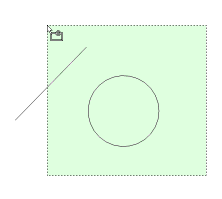

Crossing window
Selects all entities that are inside of and cross a rectangular selection window. The selection window outline is drawn in a dashed line, filled with transparent blue.

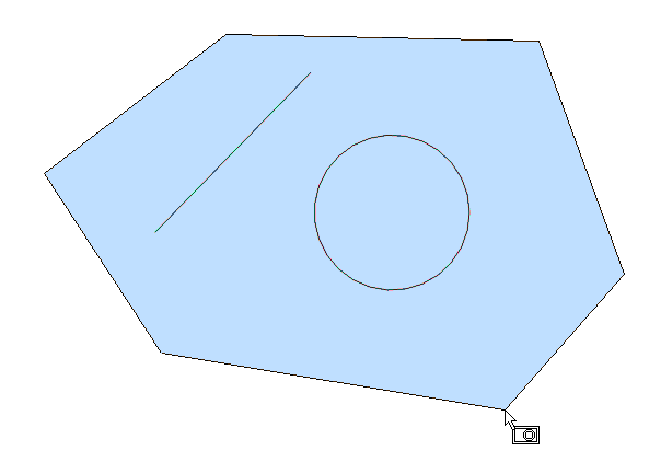

Window Polygon
Selects all entities fully inside a polygonal selection window. The selection polygon outline is drawn, filled with transparent blue.

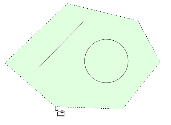

Crossing Polygon
Selects all entities inside and crossing a polygonal selection window. The selection polygon outline is drawn with a dashed line, filled with transparent green.

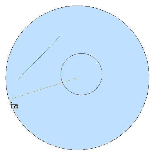

Window Circle
Selects all entities fully inside a circular selection window. The selection circle outline is drawn, filled with transparent blue.

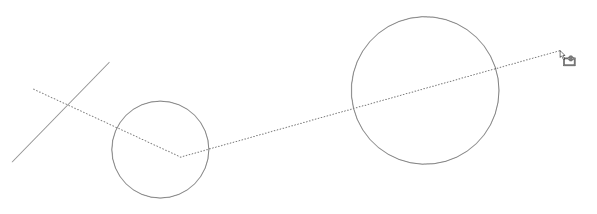

Fence
Selects all entities that cross the fence selection lines.
