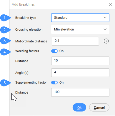

- Add Breaklines
- Adds selected linear CAD objects to the TIN Surface as breaklines.
- A dialog box opens:
- Breakline type
- Crossing elevation
- Mid-ordinate distance
- Weeding factor
- Supplementing factor
- Breakline type (1)
- Displays the selected breakline type. Select the appropriate breakline type from the drop-down list.
- Standard
- Adds breaklines to the TIN Surface, re-builds the TIN Surface so that triangles follow the breaklines edges and elevations.
- Projected
- Projects breaklines to the TIN Surface and creates new triangles, without modifying TIN Surface elevations.
- Crossing elevation (2)
- Determines which elevation is taken for triangulation at the intersection of two breaklines, added in the same Add breakline definition.
- Not allowed
- The intersection is treated as one breakline.
- Min elevation
- The elevation of lower breakline is taken.
- Mid elevation
- The middle elevation between the crossing breaklines is taken.
- Max elevation
- The elevation of upper breakline is taken.
- Mid-ordinate distance (3)
- Adds supplementary TIN points along the arc according to the mid-ordinate distance which is used for arc approximation.
- Weeding factor (4)
- Toggles the use of the weeding factor.
- Distance
- Sets the weeding distance.
- Angle (d)
- Sets the weeding angle.
Note: Existing breakline vertices are not used to create a TIN Surface, if the distance and angle between them is less than the specified weeding parameters.
- Supplementing factor (5)
- Toggles the use of the supplementing factor.
- Distance
- Sets the supplementing distance.
Note: Additional vertices are added to breakline, if the distance between vertices on the breakline is greater than the specified supplementing distance.
Note: The Supplementing and Weeding factor are disabled for the Projected breaklines.

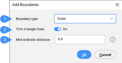

- Add bOundaries
- Adds selected linear CAD objects to the TIN Surface as boundaries.
- Boundary type
- Trim triangle lines
- Boundary type (1)
- You can choose the boundary type from the drop-down menu:
- Show
- Displays triangles inside the boundary polygon.
- Hide
- Hides triangles inside the boundary polygon.
- Outer
- Defines the outer boundary of the TIN Surface. All the triangles outside the boundary are hidden.
Note: Triangle lines are not trimmed by default.
- Clip
- Clips an existing TIN Surface in the drawing with a selected polygon as the clipping boundary for the surface.
- Does not change the TIN Surface boundary but affects all elements (TIN operations) added to the TIN Surface after the Clip boundary. Only elements located inside the Clip boundary affect triangulation.
- Trim triangle lines (2)
- Yes: trims the triangles (TIN edges) that intersect the boundary to follow the boundary polygon.
No: deletes all triangles that intersect the boundary polygon.

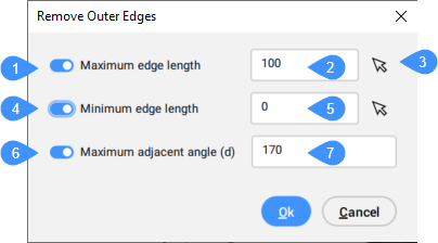

- Remove Outer Edges
- Removes triangles on the outer boundary of the TIN Surface, that have:
- greater edge length.
- shorter edge length.
- greater angle than specified.
You can specify which of these criteria is considered when removing the outer edges.
This method begins removing triangles from the outer boundary towards the inner part of the TIN Surface. It stops removing triangles, when the last outer triangle meets the specified criteria. That means that this method does not remove inside triangles.
A dialog box opens:
- Maximum edge length
- Maximum edge length value
- Pick points
- Minimum edge length
- Minimum edge length value
- Maximum adjacent angle (d)
- Maximum adjacent angle value (in degrees)
- Maximum edge length (1)
- Toggles the use of the maximum edge length.
- Maximum edge length value (2)
- Sets the value for maximum edge length.
Note: Triangles with an edge exceeding the specified maximum edge length are deleted from the TIN Surface.
- Pick points (3)
- Allows you to set the value for maximum or minimum edge length by picking points in the drawing area.
- Minimum edge length (4)
- Toggles the use of the minimum edge length.
- Minimum edge length value (5)
- Sets the value for minimum edge length.
Note: Triangles with an edge exceeding the specified minimum edge length are deleted from the TIN Surface.
- Maximum adjacent angle (d) (6)
- Toggles the use of the maximum adjacent angle.
- Maximum adjacent angle value (in degrees) (7)
- Sets the value for maximum adjacent angle.
Note: Triangles with an inner angle exceeding a specified max. angle are deleted from the TIN Surface.

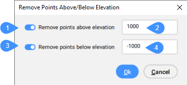

- Remove Elevations
- Removes TIN points below/above the specified elevation and displays the number of points removed.
A dialog box opens:
- Remove points above elevation
- Elevation greater than
- Remove points below elevation
- Elevation less than
- Remove points above elevation (1)
- Toggles the option to remove TIN points above a specified elevation.
- Elevation greater than (2)
- Sets the elevation above which TIN points are removed.
- Remove points below elevation (3)
- Toggles the option to remove TIN points below a specified elevation.
- Elevation less than (4)
- Sets the elevation below which TIN points are removed.
