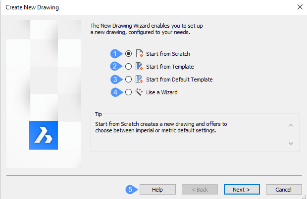

The Create New Drawing dialog box allows you to create new drawings by several methods with the New Drawing Wizard.
  1. Start from Scratch
  2. Start from Template
  3. Start from Default Template
  4. Use a Wizard
  5. Help

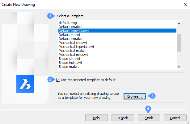

Start from Template
  1. Select a Template
  2. Use default template
  3. Browse…
  4. Finish
Select a Template
Allows you to choose a file to act as the template. From the Template list, choose one of the DWT file names. These files are stored in the folder specified by the TemplatePath variable; the default location is C:\Users\%username%\AppData\Local\Bricsys\BricsCAD\V27x64\en_US\Templates\.
Turn on Use the selected template as default option when you want to use this file as the template from now on. If so, then the program updates the value of the BASEFILE system variable. After you click the Finish button, the program opens a new drawing whose content depends on the template file you have selected.
Browse…
Opens the Select a template file dialog box from where you can select the following kind of file type for a template: DWG - drawing files, DWT - template files, DXF - drawing interchange files.
Finish
Click the Finish button after selecting a Template from the list or from the dialog box.

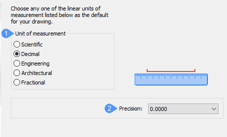

  4. Select a linear unit of measurement and display precision.
    • Unit of Measurement
    • Precision
Unit of Measurement
Choose one from the list. If you are unsure, choose Decimal; you can always change the units any time later with the UNITS command.
Unit Name Measures Example Display
Architectural Feet, inches, fractional inches 4'-6 1/16"
Engineering Feet, inches, decimal inches 4'-6.0625"
Fractional Inches, fractional inches 54 1/6"
Decimal (default) Units and decimal units 2128.4449
Scientific Units, decimal units, exponents 2.1284E+03
Precision
Click the drop-down list and choose a level of precision. If you are unsure, choose the defaults, as you can always change the precision any time later with the UNITS command.
Note: This is a display precision: the program makes calculations internally always to eight decimal places.

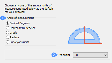

  2. Select an angular unit of measurement and display precision.
    • Angle of measurement
    • Precision
Angle of Measurement
Choose one from the list. If you are unsure, choose Decimal/Degrees; you can always change the units any time later with the UNITS command.
Angle Name Measures In Example
Decimal degrees Degrees and decimals 12.3456
Degrees/Minutes/Seconds Degrees,minutes,seconds,decimal secs 12d34'56"
Grads (g) Grads and decimals 123.45g
Radians (r) Radians and decimals 1.23r
Surveyor’s Units North/South degrees towards East/West N12d34'56"E
Precision

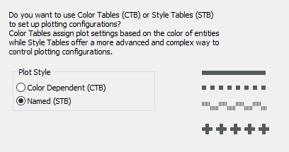

  2. Determine which kinds of plot style the drawing should employ:
    • Color Dependent (CTB) - these plot styles are simpler to employ, but less flexible.
    • Named (STB) - plot styles are more flexible, but complex, because they control every aspect of every entity property during plotting.
    If you are unsure, choose Color-dependent.

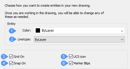

  4. Choose the default working color, the linetype and the visual aids you want to be displayed by the drawing:
    1. Color
    2. Linetype
    3. Grid On
    4. Snap On
    5. UCS icon
    6. Marker Blips
Color
You can choose any color from the drop-down list. However, this is not recommended. Choose ByLayer so that layers control the colors of entities. See COLOR and LAYER commands.
Linetype
You can choose any linetype from the drop-down list, this again is not recommended. Choose ByLayer, for the same reason. See LINETYPE command.
Grid On
When on, displays a grid of dots (or lines) that helps you see the unit spacing, as well as drawing extents, such as every 1m; see the GRID command. It is recommended you turn this on.
Snap On
When on, sets the movement increment of the cursor, such as every 0.5m; see SNAP command. It is recommended you turn this on.
UCS icon
When on, displays the UCS icon for showing the orientation of the x, y, and z axes; see the UCSICON command. It is recommended that you turn this on for 3D drawings, but turn it off for 2D ones.
Marker Blips
When on, draws a tiny + each time you click in the drawing; see the BLIPMODE command. It is recommended you leave this one off, as it can turn the screen messy.
