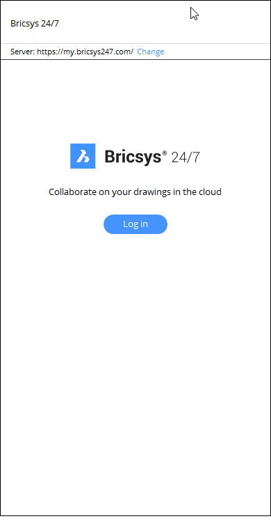

On servers like https:/my.bricsys247.com/, with default scope settings, the log in appears as described below.
Click the Log in button to open the Bricsys website, allowing you to log in to your Bricsys account. For more information on how to log in, see the Log in with your Bricsys account article.
Click the Change button to open the Settings dialog box at the CLOUDSERVER system variable to specify another address of the Bricsys 24/7 server. For other certain environments, like https://pellikaan.bricsys247.com/, that do not support SSO at this moment, the Log in with your Bricsys account section on the Bricsys website can be different. For Log in follow the steps:

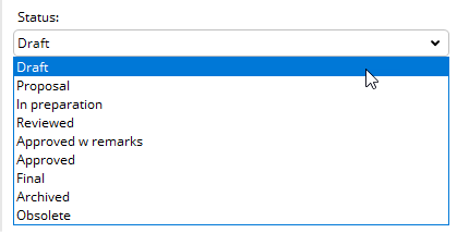

    (7) Add a new file Opens the Add new document dialog box to add a new file to the folder.
    Choose a file status from the drop-down list and type a description.
    Note: If the folder where you upload the file contains metadata, a form appears and you can fill it out.
