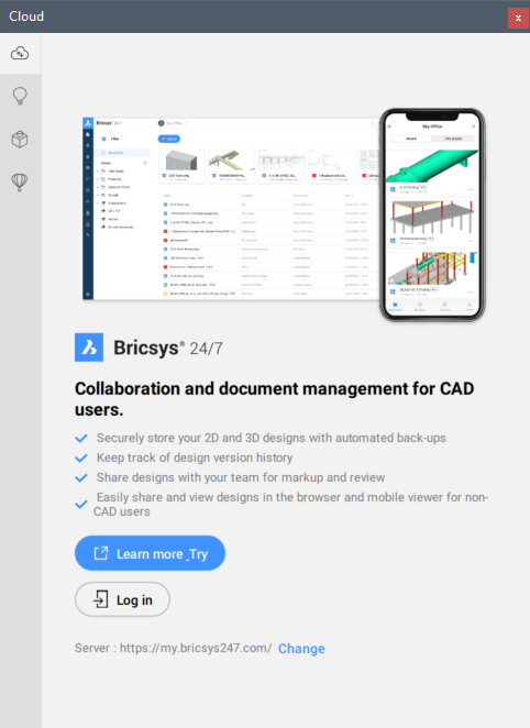

Log in
The CLOUDSSOCLIENTID system variable stores the client_id to be used when connecting to SSO service.
The CLOUDSSOSCOPE system variable stores the scopes or permissions to be used when connecting to SSO service. It depends on the authorization server for a given Bricsys 24/7 service (what scopes are configured/allowed for the client). For example, Azure AD requires an explicit client id on the scope parameter, like <client id>/access_as_user openid.
The default server used is https:/my.bricsys247.com/, but it can be changed by clicking Change button, which opens the Settings dialog box for the CLOUDSERVER system variable, which allows you to specify a different address for the Bricsys 24/7 server.
Click the Log in button to open the Bricsys website, allowing you to log in to your Bricsys account. For more information on how to log in, see the Log in with your Bricsys account article.
For other certain environments, like https://pellikaan.bricsys247.com/, that does not support SSO at this moment, the log in dialog box can be different. For Log in follow the steps:
  1. Enter your Email address and Password and press the Log in button.
  2. (Optional) Tick the Remember me checkbox to store the username and password.
  3. Once logged in, you will see an overview of your in the cloud Projects, Folders and Documents.

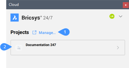

The Cloud panel content
  1. Manage
  2. Project name
  3. Tree structure of the project
  4. Active Folder
  5. Open in Browser button
  6. Pop-up menu
  7. New drawing button
  8. Save current drawing button
  9. Import files button
  10. Home button
  11. Refresh button
  12. Characteristics of the files
  13. Files list
Manage
Opens the Bricsys 24/7 application in browser https://my.bricsys247.com/app/.
Project name
When logged in, in the Cloud panel you will see all the projects you are assigned to. Choose a project and open it by pressing the right-side arrow.
Lists all the folders is in the project.
Active Folder
Marks the active folder name. In the right side of the panel there are all files included in this folder.
