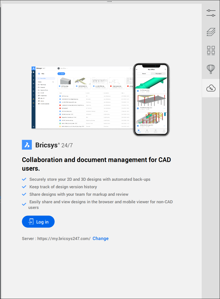

Log in
The CLOUDSSOCLIENTID system variable stores the client_id to be used when connecting to SSO service.
The CLOUDSSOSCOPE system variable stores the scopes or permissions to be used when connecting to SSO service. It depends on the authorization server for a given Bricsys 24/7 service (what scopes are configured/allowed for the client). For example, Azure AD requires an explicit client id on the scope parameter, like <client id>/access_as_user openid.
The default server used is https:/my.bricsys247.com/, but it can be changed by clicking Change button, which opens the Settings dialog box for the CLOUDSERVER system variable, which allows you to specify a different address for the Bricsys 24/7 server.
Click the Log in button to open the BricsCAD website, allowing you to log in to your BricsCAD account. For more information on how to log in, see the Log in with your account article.

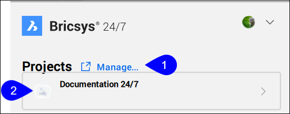

Manage
Opens the Bricsys 24/7 application in browser https://my.bricsys247.com/app/.
Project name
When logged in, in the Cloud panel you will see all the projects you are assigned to. Choose a project and open it by pressing the right-side arrow.
Tree structure of the project
Lists all the folders is in the project.
Active Folder
Marks the active folder name. In the right side of the panel there are all files included in this folder.
Open in Browser button

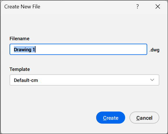

New drawing button
Opens the Create New File dialog box, a new file will be created in the local cache cloud folder. The file can then be uploaded to the correct project and folder with a single click.
Filename
Defines a file name for the new drawing.
Template
Allows you to choose a template for the new drawing.

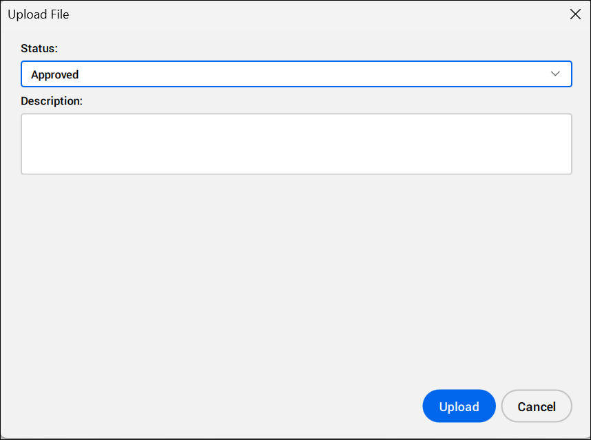

  • Upload as revision: opens the Upload File dialog box to upload your file as a revision of the original file.
    For drawing files, see the CLOUDUPLOADDEPENDENCIES system variable options.

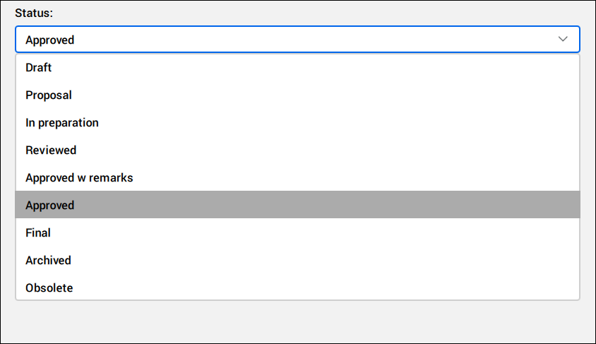

    Status
    Allows you to choose the status of the new file from the drop-down list and a description.
    Allows you to write a description for the revision.
    Upload
    Uploads the file.
