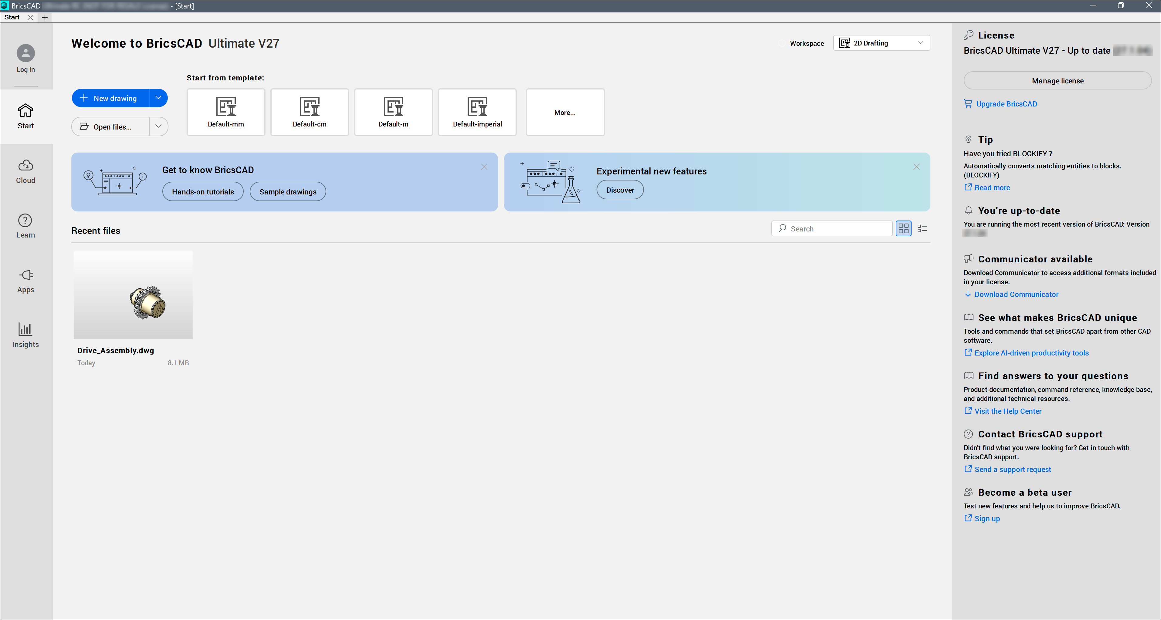

Start tab
Workspace
Allows you to choose the workspace from the drop-down menu.
Start from template
Displays the last used templates. Click the More... button to open the Create New Drawing From Template dialog box. You can select a template from the list or you can browse for a custom template to create a new drawing. Each workspace has some predefined templates for new drawings.
New drawing
Creates a new drawing using the current drawing template.
Note: When using the BIM workspace, you can choose between creating a new project or a new drawing.
Click the right-side arrow to display additional options.
Create new sheet set
Opens the Create New Sheet Set dialog box.
Start new wizard
Opens the Create New Drawing dialog box.
Open files
Opens the Open file dialog box to browse for an existing drawing.
Open files (read-only)
Opens the file selected from the Open file (read-only) dialog box only for reading.
Open a sheet set
Opens the Select a Sheet Set file dialog box to browse for a sheet set file.
Recover
Opens the Open Drawing dialog box to choose a file to recover.
Get to know BricsCAD
Provides step-by-step guidance for using BricsCAD in the selected workspace. The TUTORIALSOPEN command launches.
Note: The TUTORIALSONSTARTPAGE system variable controls the display of this option.
Experimental new features
Provides access to the Experimental Features dialog box by pressing the Discover or Manage button.
Note:
  • The EXPERIMENTALONSTARTPAGE system variable controls the display of this option in the Start tab. A new value is considered only after restarting the program.
  • The Manage and Give us feedback buttons are available when Experimental Features are enabled.
  • The Give us feedback opens a web page where you can send us your feedback about Experimental Features.
Recent files
Displays a list of recently opened files. Click the thumbnail image of the file to open it.
Note:
  • The number of available recent files is controlled by the value of the RECENTFILES system variable.
  • You can arrange the file in Grid view or Table view mode and search for a specific file.
Right-side panel
Displays the license level used in the current BricsCAD session and the status of your BricsCAD installation. The panel indicates if an update is available or if you are offline and BricsCAD can not check for updates. Depending on whether you have a trial or an active license, it provides options to buy, activate, or manage a license. It also offers access to relevant documentation and helpful guidance.
Note: In BricsCAD trial mode, the Show Trial Startup Setup option displays or hides the BricsCAD Setup dialog box at startup and sets the GETSTARTED system variable accordingly.

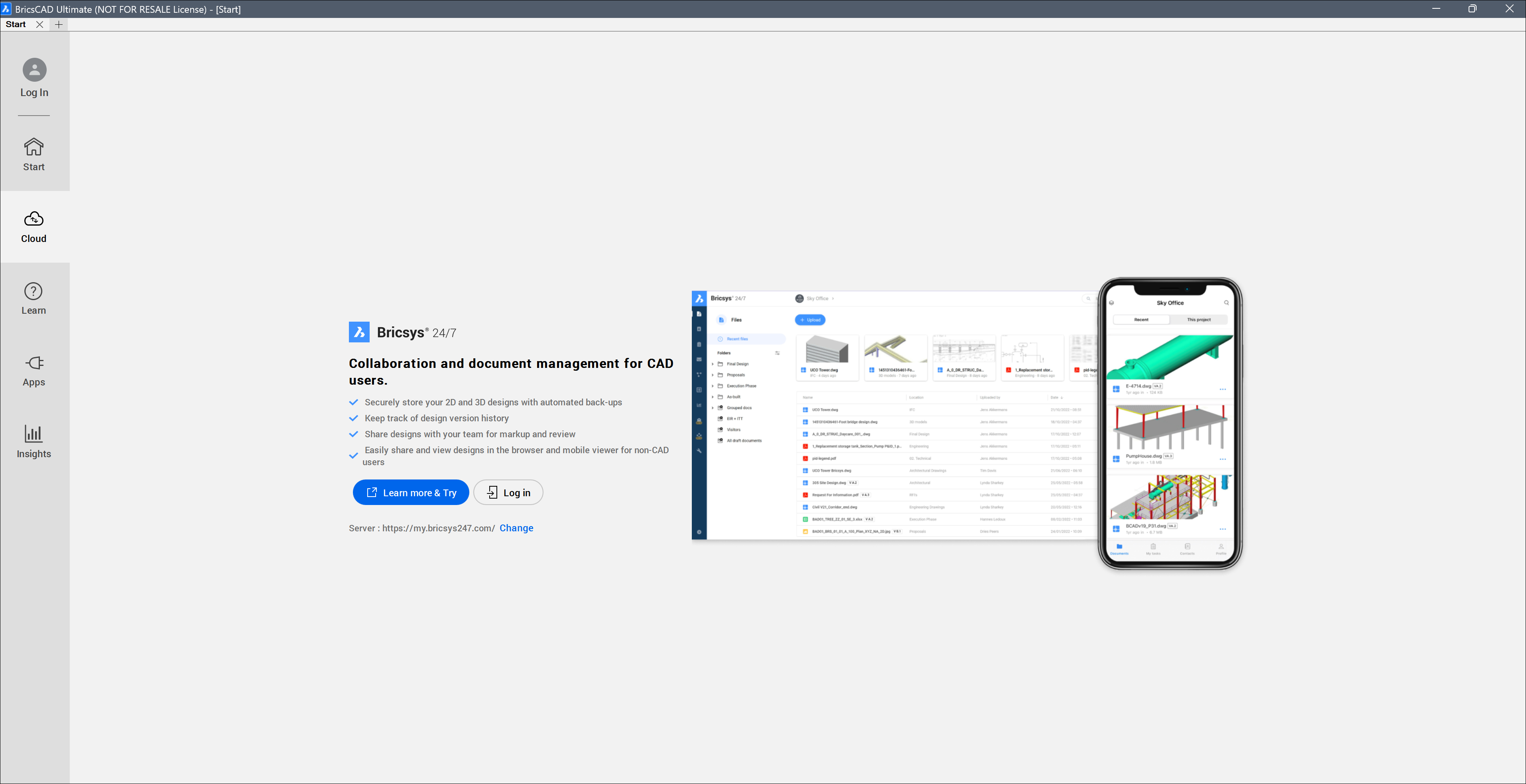

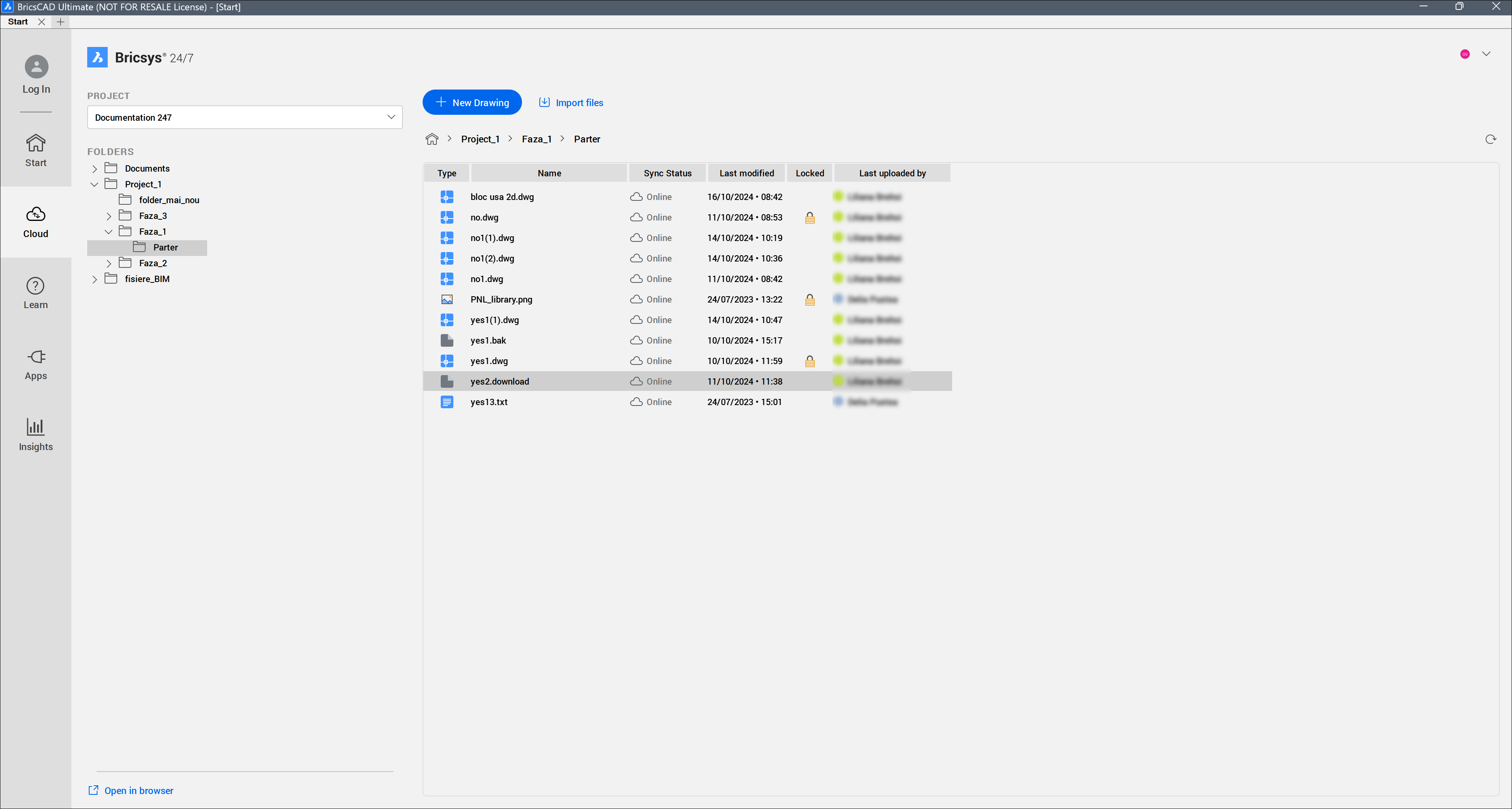

Cloud tab
The Cloud tab provides collaboration and document management for CAD users.
See more information about the Cloud feature in the Cloud panel article.

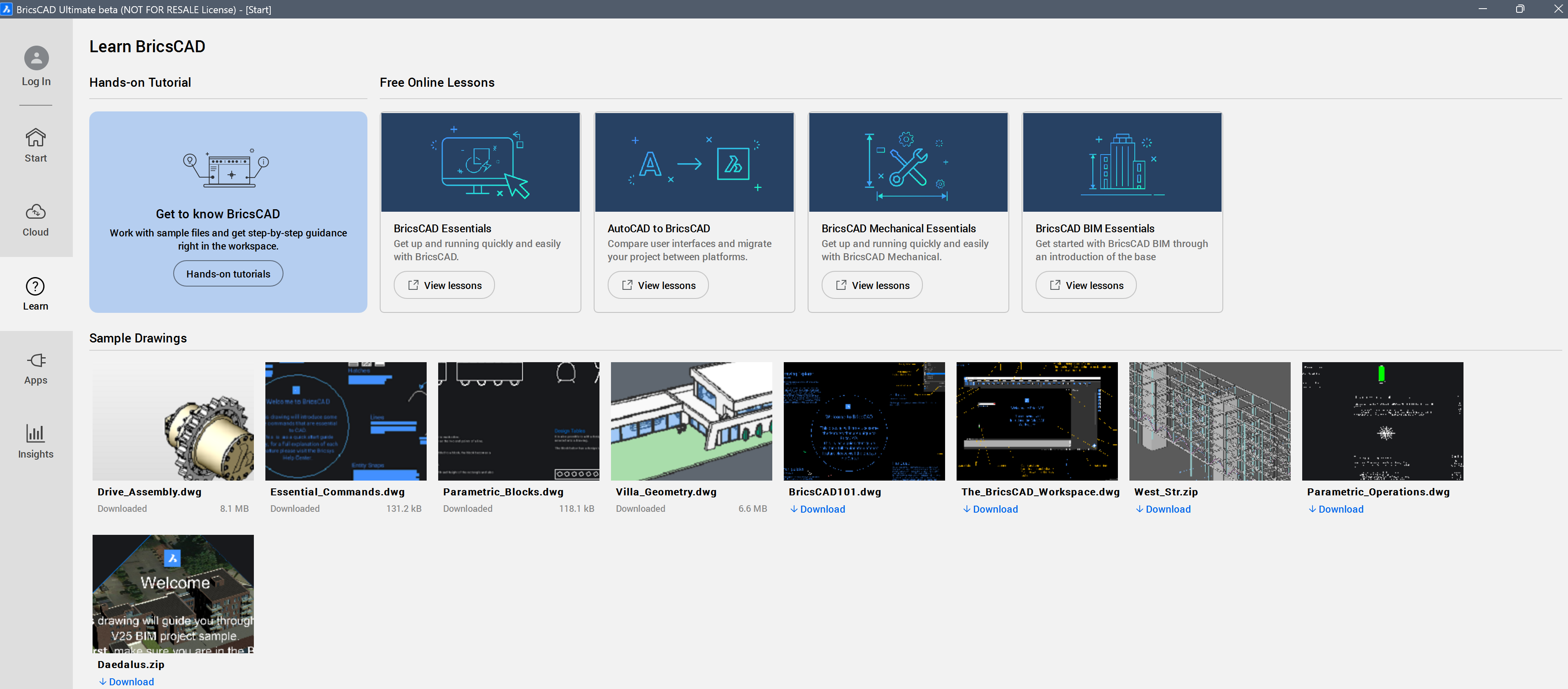

Learn tab
Offers sample drawings for use and free video lessons to learn BricsCAD.

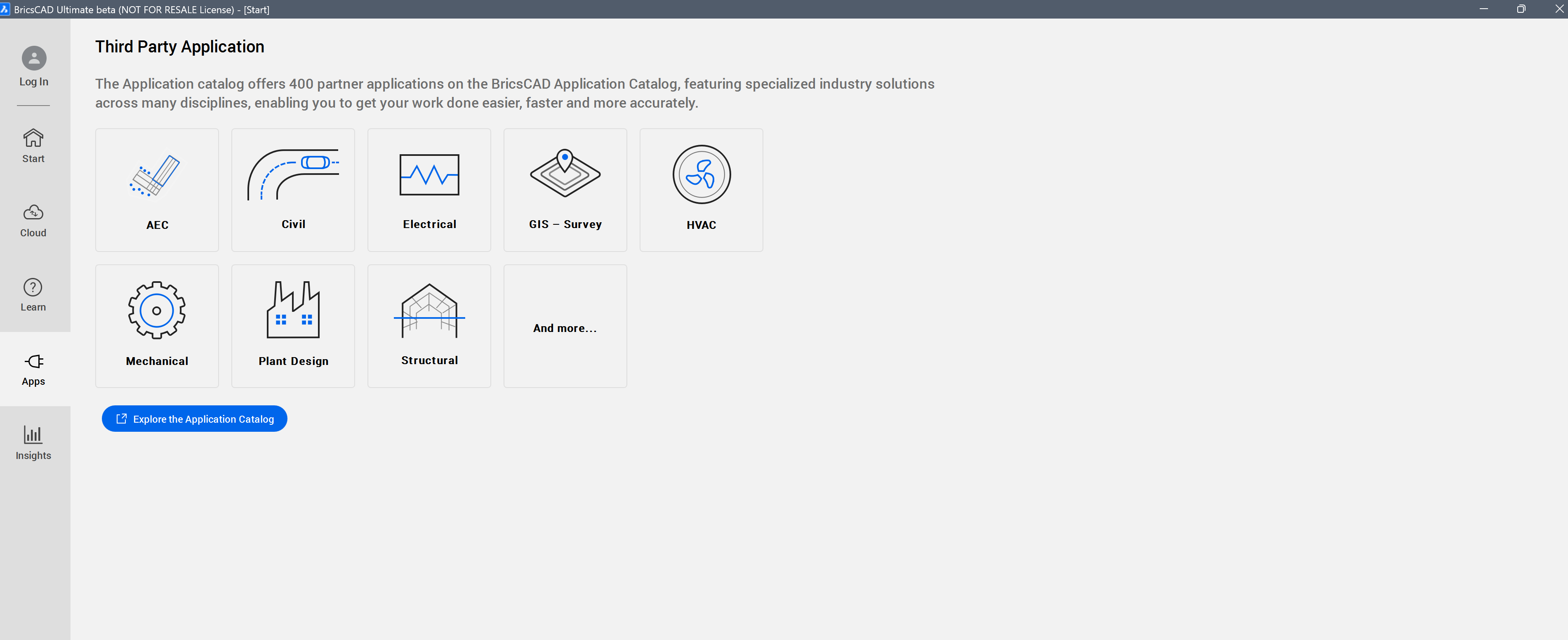

Apps tab
The BricsCAD Application Catalog offers 400 partner applications, featuring specialized industry solutions across many disciplines, enabling you to get your work done easier, faster, and more accurately.
Tip:
  • When you click a category, the BricsCAD Application Catalog opens and filters applications based on the selected category.
  • Click the Explore the Application Catalog to open the full BricsCAD Application Catalog.

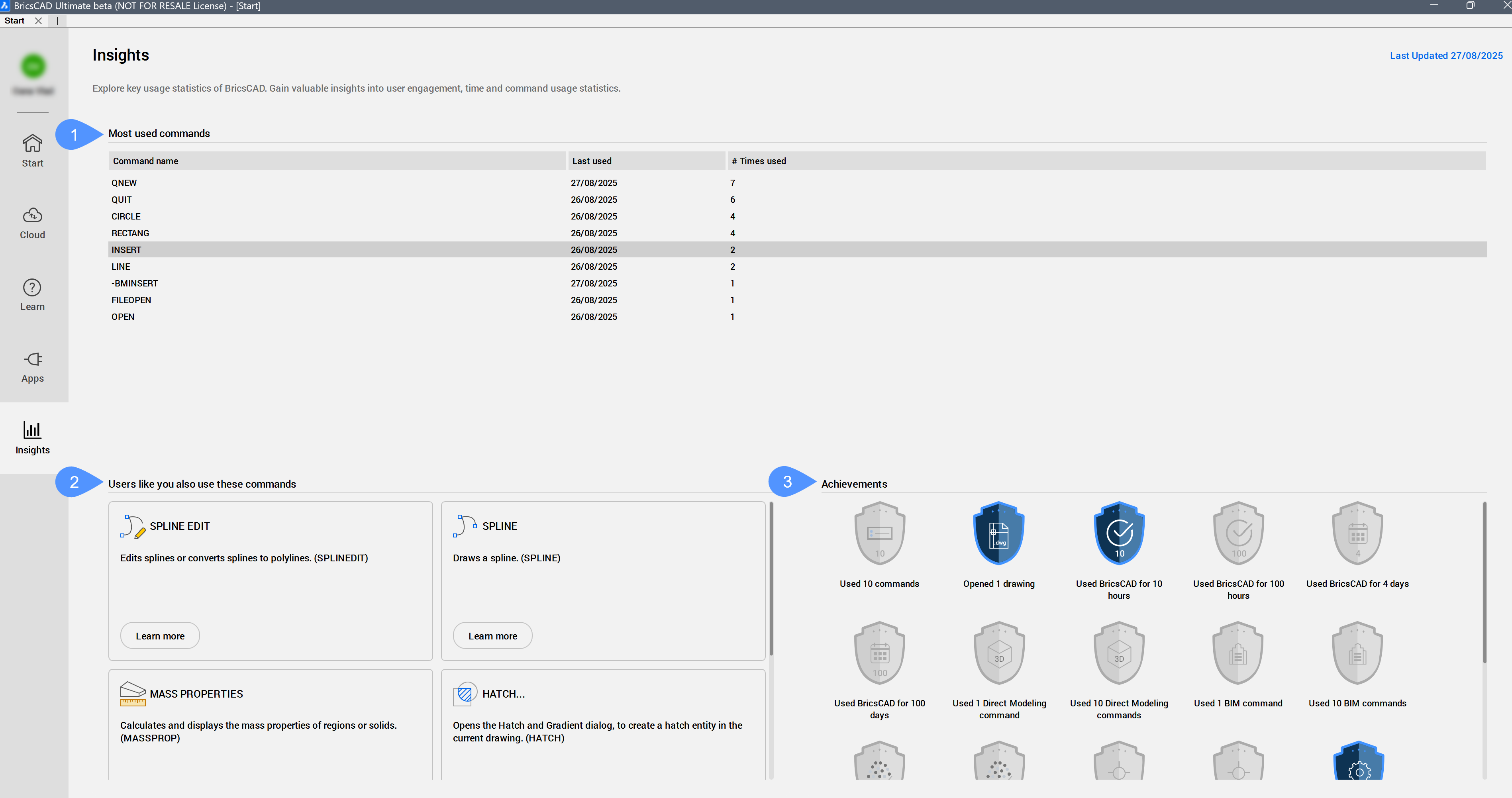

Insights tab
Allows you to see summary statistics on the data that you have shared with the BricsCAD servers.
The Insights tab contains an overview of your most used commands, commands that might be interesting for you and achievements.
Note: You need to join the BricsCAD Analytics Program to get insights. See more information in the BricsCAD Analytics Program article.
Most used commands
Lists the name of the most used commands, the last time used and how many times you used the commands.
Users like you also use these commands
Lists commands based on how users similar to you use the application.
Click the Learn more button to open the relevant Help Center article.
Achievements
The achievements have two states, blue and gray.
Blue means the achievement has been completed.
Gray means the achievement has not been completed yet.
Note: The Insights tab does not provide live updates. It is updated several times a day on the cloud side.
