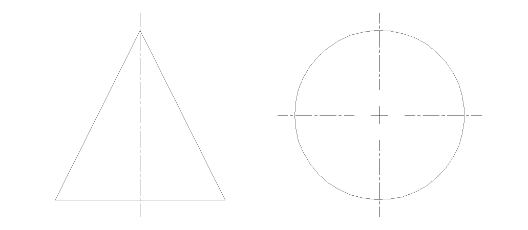

CENTEREXE system variable
Centerline extension length
Controls the extension length of a centerline.
| Type: | Real |
| Saved in: | Drawing |
| Default value: |
0.12 Note: The default value applies when the MEASUREMENT system variable is set to 0 and the INSUNITS system variable is set to inches. When the MEASUREMENT system variable is set to 1 and the INSUNITS system variable is set to millimeters, the default value is 3.5.
Note: The value is expressed in drawing units.
