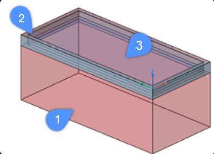

This process is explained in 4 parts to make the steps of creating a 3D window or door geometry straightforward.
  • Create the file
  • Create the subtractor solid (1)
  • Create the window or door frame (2)
  • Create the (Glass) panes (3)

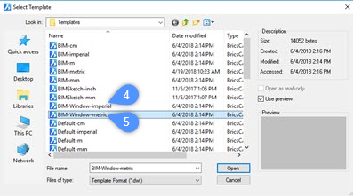

  1. Click New in the File menu.
  2. Select one of the pre-defined templates to create a simple window specifying the unit system of your drawing.
    Note: The pre-defined templates contain the layers needed to create the geometry of the window or door. These DWT file format templates are BIM-Window-imperial (4) and BIM-Window-metric (5) which assure the required layers and properties are displayed in your drawing.

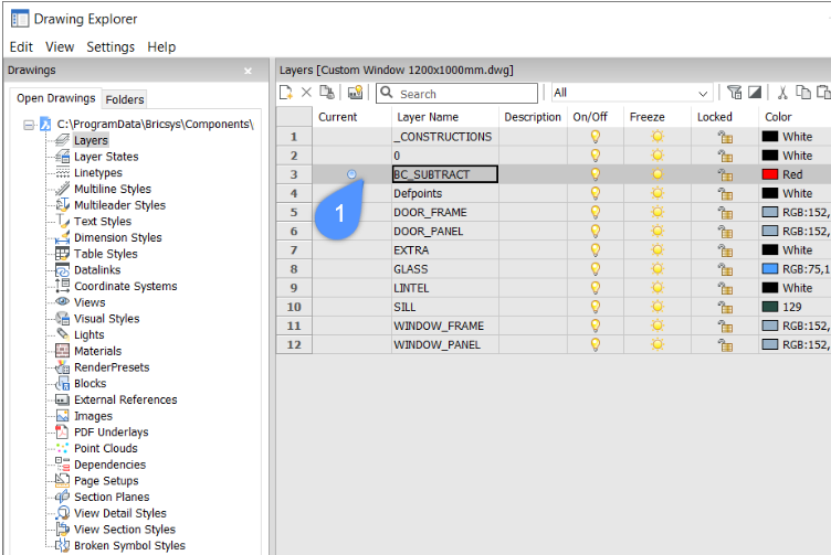

  3. Set the BC_SUBTRACT layer current (6) either using the drawing explorer or layer field in the Properties panel or Layers panel on the right-hand side.

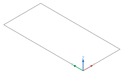

  4. Create a closed polyline (e.g. a rectangle) that represents the form of the opening for the insert.

  1. Use the outline of the solid which you have previously created (e.g. a rectangle).

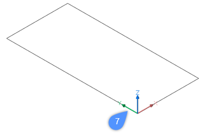

    The outline lies in the first quadrant of the XY plane of the World Coordinate System (WCS).
    The lower left corner of the rectangle lies at the origin (0,0,0) of the WCS (7).

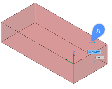

  2. Select the Extrude tool and move the cursor downward (8) to extrude your solid outline in the negative Z direction.
  3. Do one of the following to finish the subtractor solid creation.
    • Click a point.
    • Type a value in the dynamic dimension fields, then press Enter.
    Note: Make sure that the height of the extrusion is greater than the width of the wall the component will be inserted into.

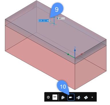

  2. Highlight the top face of the subtractor solid.

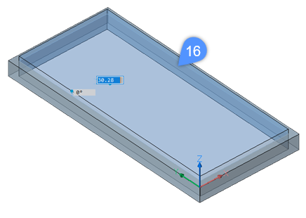

  3. Next, extrude the top face of the subtractor solid in the negative Z direction (9) using the Extrude tool ‘Create’ (10) option by pressing the Ctrl key once.
  4. Type a value in the dynamic dimension field to specify the height of the fixed frame.
    Note: The height of the extrusion will be the thickness of the fixed frame.

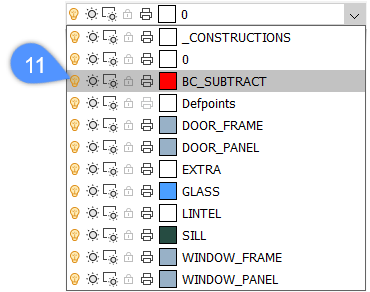

  5. Turn off the BC_SUBTRACT layer by clicking the light bulb (11) next to the layer name.

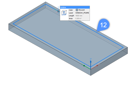

  6. Use the Offset tool to create a parallel offset of the outline of the fixed frame (12).
    Note: The distance of the offset equals the width of the frame.

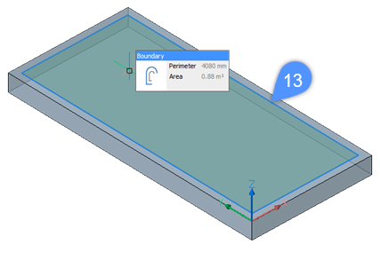

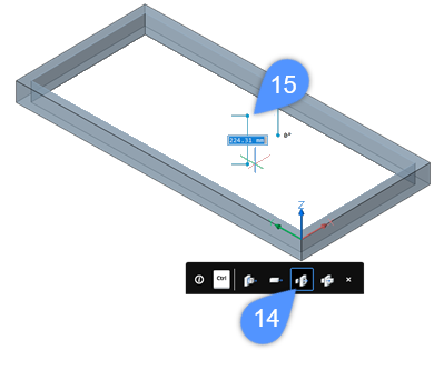

  7. Hover over the inside boundary of the parallel offset (13) and select Extrude tool from the Quad.
  8. When the extrude mode is on the Subtract option (14), move your cursor downward (15) to create an opening in the fixed frame.
  9. Do one of the following to finish the creation of the opening in the fixed frame.
    • Click a point.

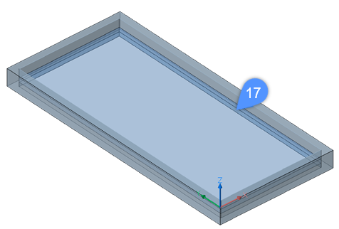

  3. Move the glass pane solid down in the negative Z-direction if the outside face of the fixed frame does not coincide with the outside face of the solid (wall) the insert will be placed in.
    The following illustrations show the glass pane solid after moving it (17) down.

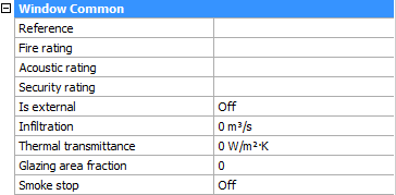

  6. Optionally, you can assign more information to the window after inserting it into a new drawing. The following illustration shows the Window Common category of BIM properties from the Properties panel that becomes available after selecting the element. Information can be assigned about the thermal transmittance coefficient of the window materials, fire rating according to the national fire safety classification, and so on.
