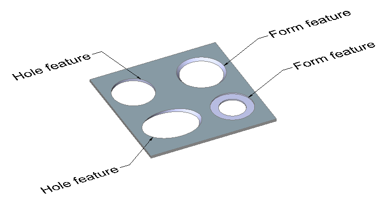

Hole features are a simplified version of Form Features. In the image below you can see different features, which have only thickness faces (the SMCONVERT command respects these rules):
  • Orthogonal holes are hole features.
  • Simple non-orthogonal holes are hole features.
  • Chamfered orthogonal holes are form features.
  • If the hole thickness face consists of 2 different regions, it is a form feature.

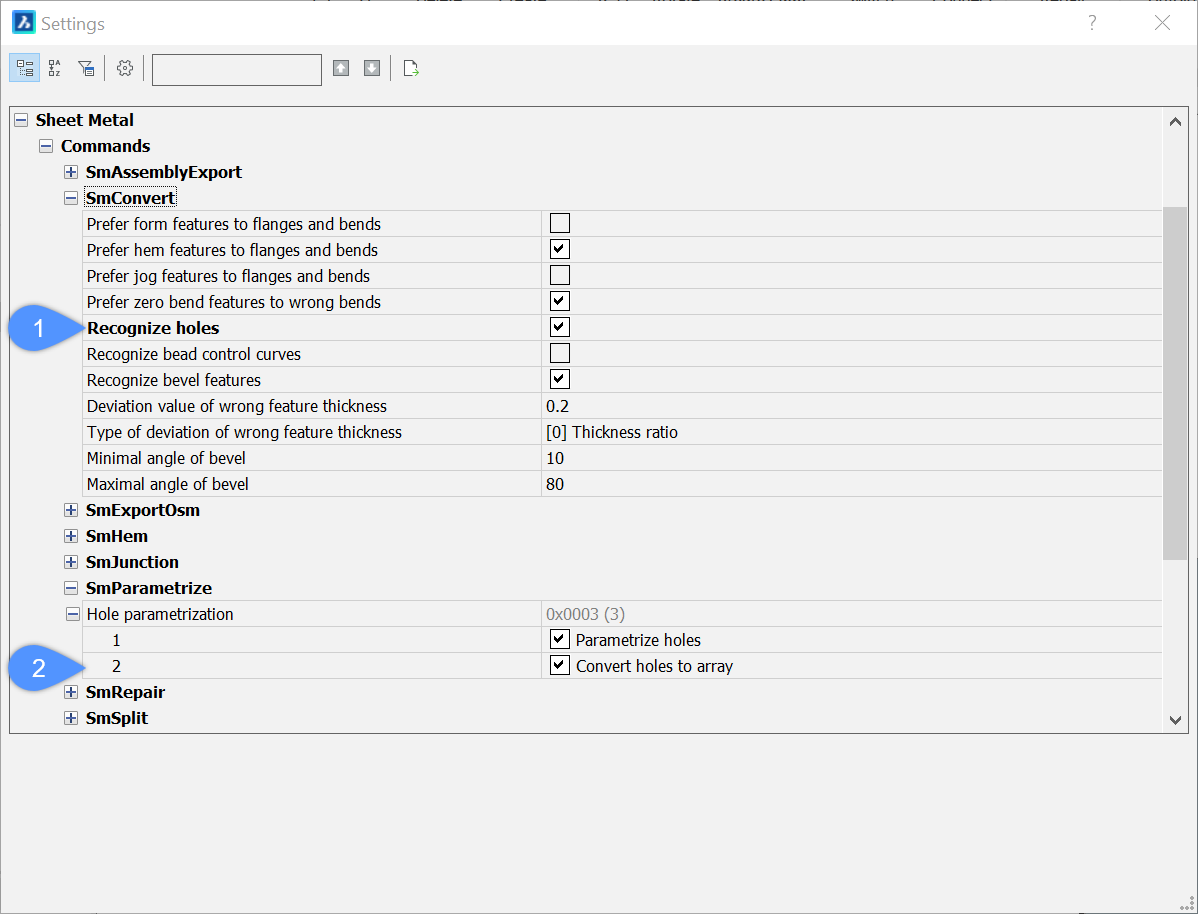

  1. In the Settings dialog box (SETTINGS command), go to Sheet Metal > Commands.
  2. For SmConvert, select the Recognize holes option.
  3. For SmParametrize, select the Convert holes to array and Parametrize holes options.

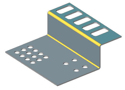

    11 hole features are recognized on the part.

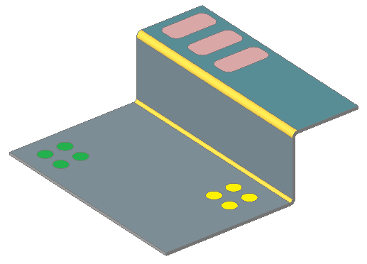

    To examine the arrays, you can temporarily unfreeze the BC_SUBTRACT layer.
    In the image below the arrays are colored manually.
    Note: The green and yellow arrays are not unified. Otherwise the array would have missing holes.

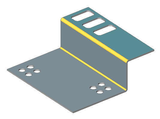

  11. Edit the Array Properties in the Mechanical Browser.
    In the image below the following has been modified:
    • Green array: number of rows and columns from 2x2 to 3x4.
    • Yellow array: X and Y spacing.
    • Red array: number of rows and columns from 3x1 to 5x1.
