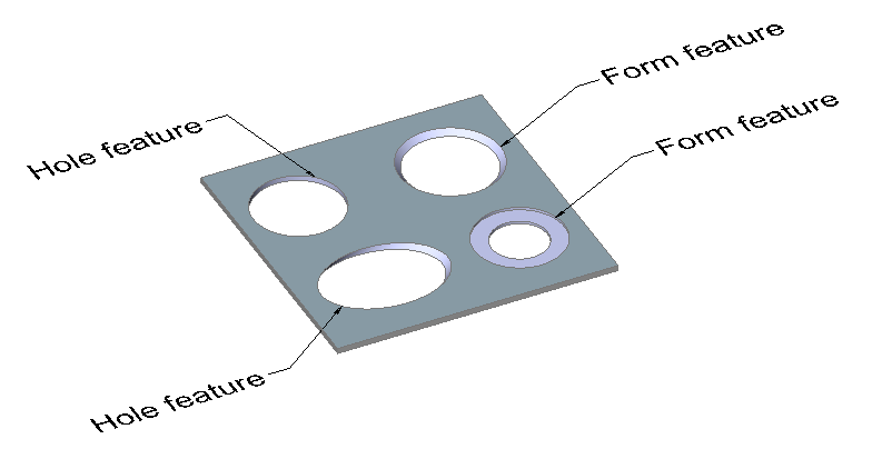

Hole features are a simplified version of Form Features. In the image below you can see different features, which have only thickness faces (the SMCONVERT command respects these rules):
  • Orthogonal holes are hole features.
  • Simple non-orthogonal holes are hole features.
  • Chamfered orthogonal holes are form features.
  • If the hole thickness face consists of 2 different regions, it is a form feature.
Hole features are recognized by the SMCONVERT command if the SMCONVERTRECOGNIZEHOLES user preference is On.

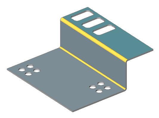

    11 hole features are recognized on the part.
  8. Run the SMPARAMETRIZE command.
  9. Do one of the following:
    • Click the Parametrize tool button () on the Sheet Metal toolbar.
    • Click the Parametrize tool button () on the Sheet Metal ribbon panel.
    • Choose Parametrize in the Sheet Metal menu.
      You are prompted: Select 3D solids to parametrize or [Entire model] <Entire model>:
  10. Press Enter to process the sheet metal part.
    The command reports must look like the one below:
    Created 4 distance constraints
    Created 3 fix constraints
    Created 0 coincident constraints
    Created 0 tangent constraints
    Created 0 rigid set constraints
    Created rectangular array 2x2 basing on Hole_3 feature
    Created rectangular array 2x2 basing on Hole_7 feature
    Created rectangular array 3x1 basing on Hole_9 feature
    Total: 7 constraints and 3 array(s) created

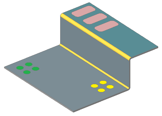

    To examine the arrays, you can temporarily unfreeze the BC_SUBTRACT layer.
    In the image below the arrays are colored manually.
    Note: The green and yellow arrays are not unified. Otherwise the array would have missing holes.

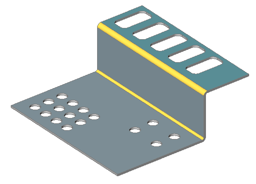

  11. Edit the Array Properties in the Mechanical Browser.
    In the image below the following has been modified:
    • Green array: number of rows and columns from 2x2 to 3x4.
    • Yellow array: X and Y spacing.
    • Red array: number of rows and columns from 3x1 to 5x1.
