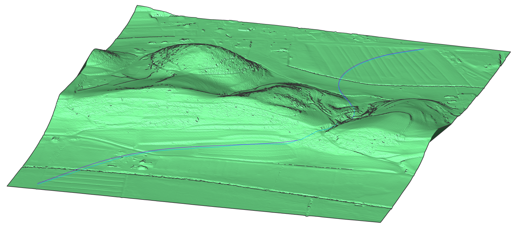

Procedure: Creating an Alignment by PI
- Open the drawing file that contains a TIN Surface.
- Launch the ALIGNMENT command in the Command line.
- Select the TIN surface.
- Optionally, select the Specify start station option in the Command line to define start station for the alignment
- Pick the horizontal alignment PI points on your surface. Press ENTER when done. Your 3D alignments (1) and horizontal alignment (2) are now generated.

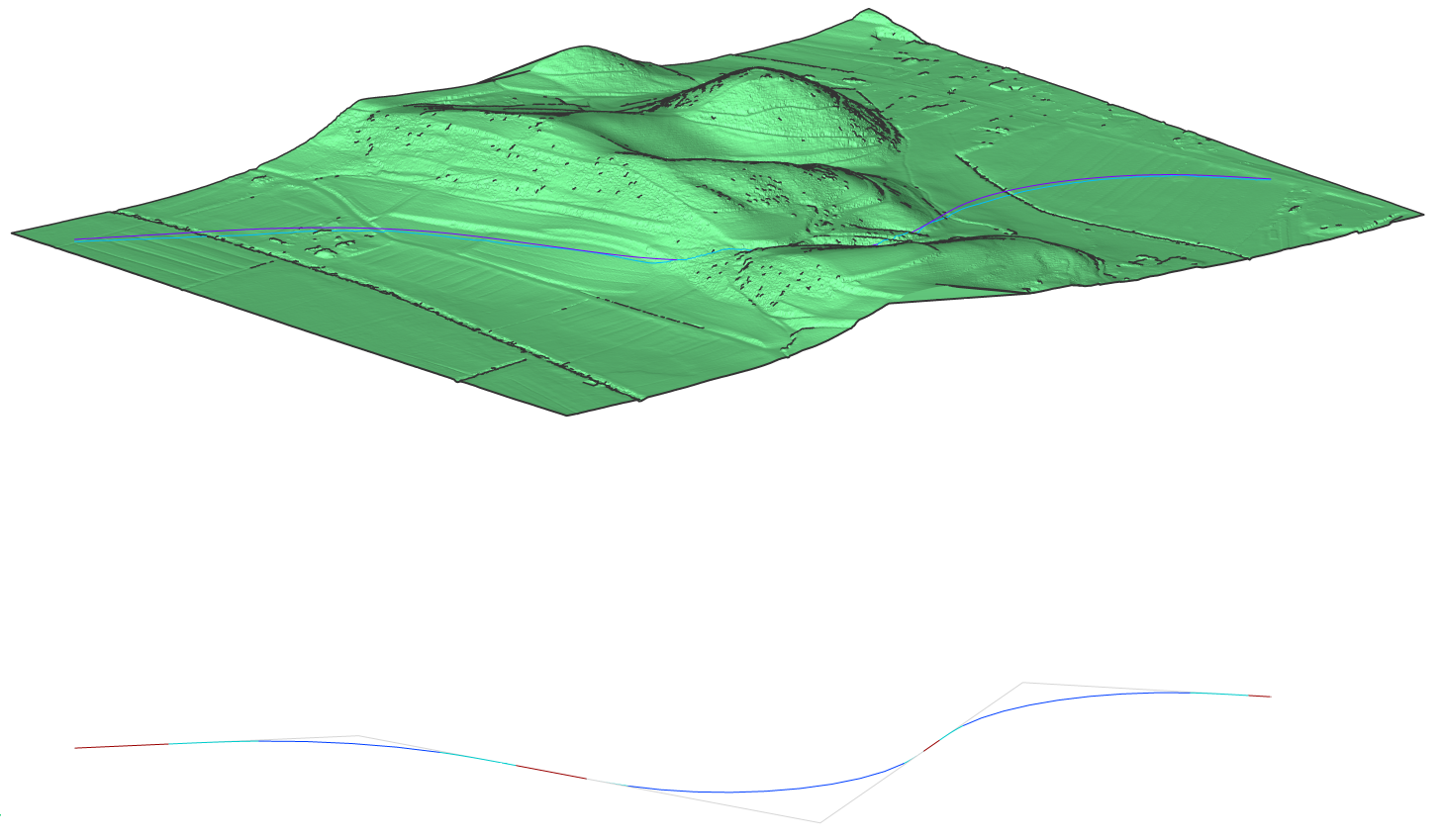

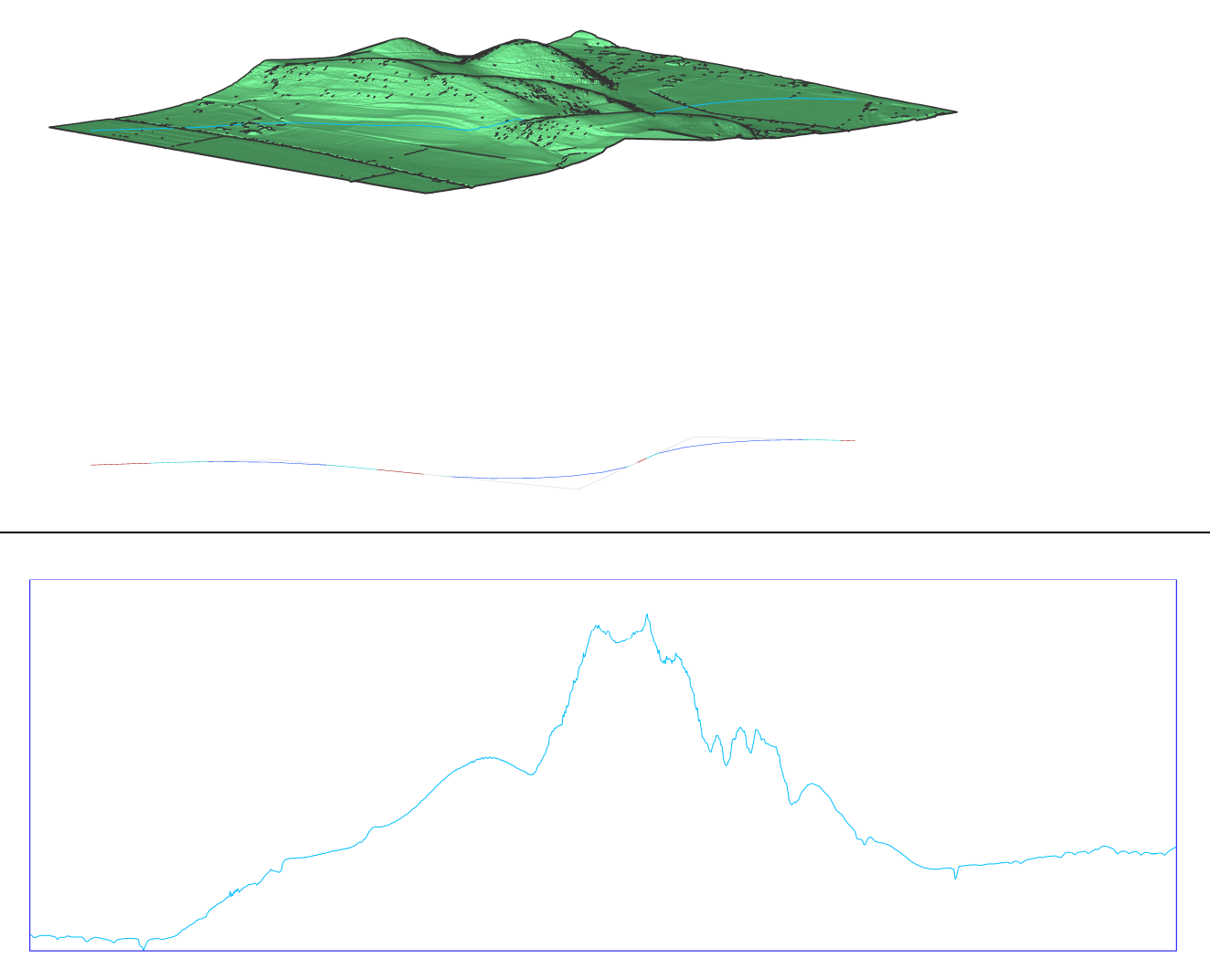

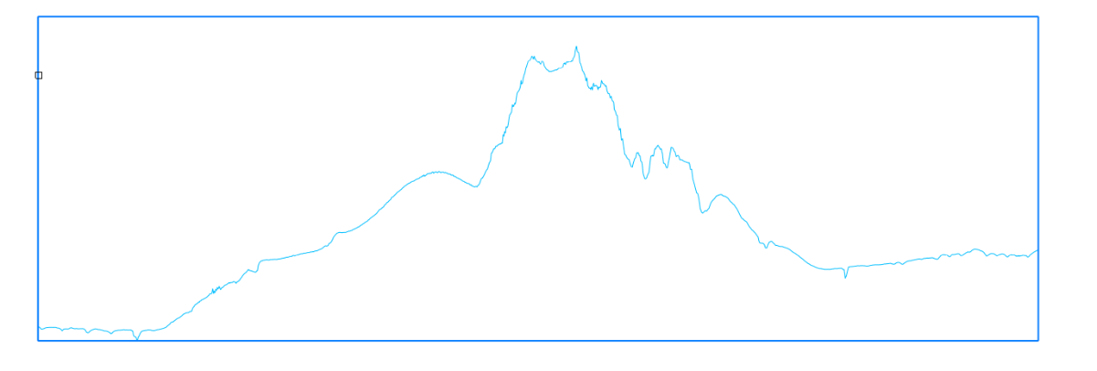

About Vertical Alignment View
The horizontal alignment creates a vertical section of the target TIN surface. This 2D curve can be displayed in a separate viewport inside your model space using the command ALIGNMENTVIEW.
Creating a Vertical Alignment View
- Open the drawing file that contains a TIN Surface, Horizontal Alignment and 3D Alignments.
- Launch the ALIGNMENTVIEW command in the Command line.
- Select a horizontal or 3d alignment in the drawing.Note: If you select the Horizontal alignment in a drawing that is not projected yet on TIN Surface, then TIN Surface needs to be selected in the next step.
- Pick a point as origin for the vertical alignment view.
Your vertical alignment view is now generated.

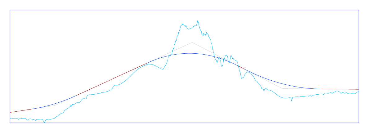

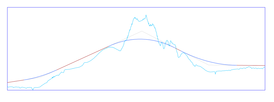

- Open the drawing file that contains a TIN Surface, Horizontal Alignment and Vertical Alignment View.
- Launch the ALIGNMENTVERTICAL command in the Command line.
- Select vertical alignment view in the drawing.
- Pick the vertical alignment PVI points. Press ENTER when done. If you want to go one step back, use Undo. Automatic 3d alignment option generates vertical alignment automatically. Your vertical alignment is now generated.
