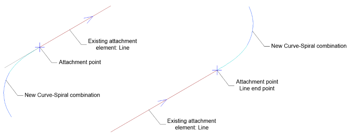

- CS curve with spiral
- Attach a Curve-Spiral combination before (to) or after (from) the selected alignment element. As the name implies, a combination consists of two elements, a spiral and a curve.Note: The sequence of created elements depends on whether the combination is attached before or after the selected element. To create a combination before the selected element, select existing element closer to its start point. In this way we get the Curve-Spiral combination. Otherwise, if attachment point is selected closer to element end point, then we get the Spiral-Curve combination. Such combination starts by spiral transition to a curve, which passes through a specified pass-through point.
First select the attachment element, then specify spiral radius and length, then specify the curve solution angle (greater or less than 180°) and last specify the curve pass-through point to draw the Curve-Spiral combination.

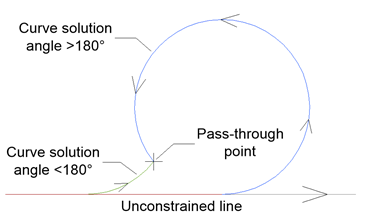

- Is curve solution angle
- Toggles between Greaterthan180 and Lessthan180.The figure below shows two possible solutions for the curve passes through the same specified point, depends on the selected option for the curve solution angle.

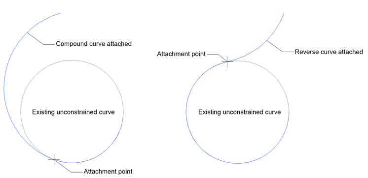

- Is curve compound or reverse?
- Toggles between Compound and Reverse curve attached to existing unconstrained curve element, as illustrated in the figure below:
