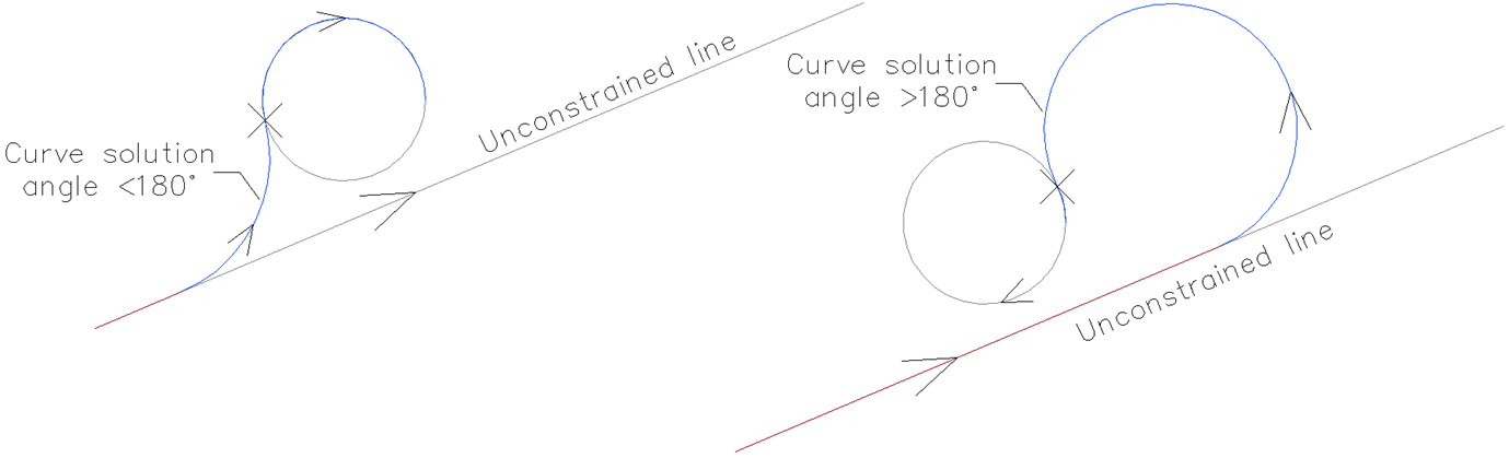

- Is curve solution angle
- Toggles between Greaterthan180 and Lessthan180.
The figure below shows two possible solutions for a curve with an angle < 180° (left) and > 180° (right) added between an unconstrained line and an arc element.

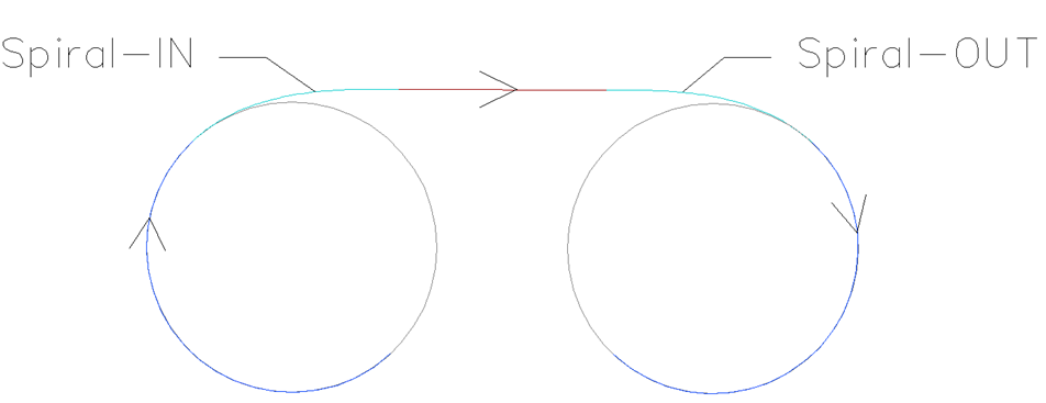

- Spiral in-length
- Allows you to specify the spiral-in length.
- Spiral out-length
- Allows you to specify the spiral-out length.
The figure below shows the spiral-line-spiral combination, created between two unconstrained curves, where the user specifies the spiral-IN and spiral-OUT lengths.
