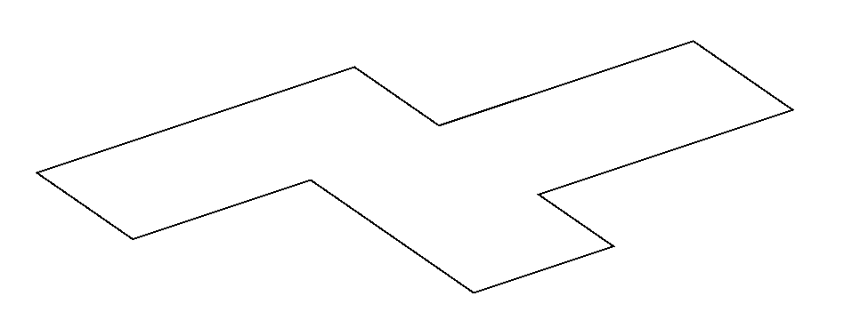

- Boundaries are the features to define bounded 3D surfaces. The surface boundaries can be created with closed polylines. Defining outer boundaries on a large 3D surface improves the performance of a TIN Surface plan.

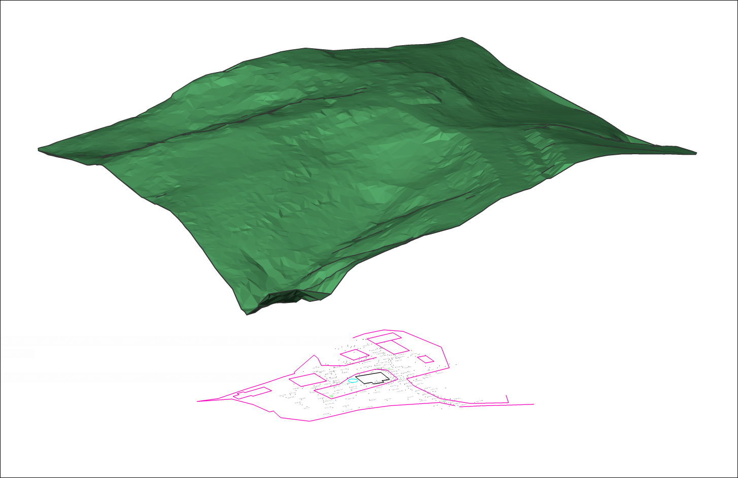

Creating a TIN Surface is a process that needs to be followed to map a particular area in detail. On BIM models, these surfaces are used to represent the site. The TIN surface can be generated from large data sets such us Point Clouds, from drawing entities, from 3D Faces, from custom ASCII point files, from Civil 3D surfaces.

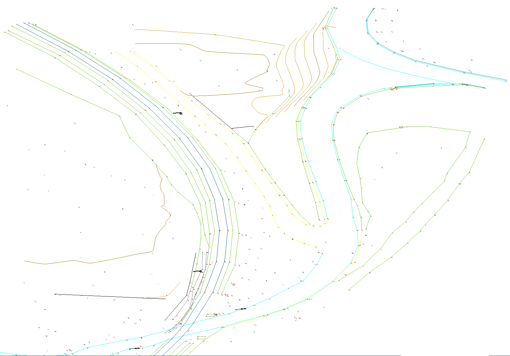

Procedure: Creating a TIN Surface from drawing entities
- Open the drawing that contains drawing entities, such as CAD points, blocks and polylines.
- Launch the TIN command.
- Select all entities in the drawing.
- Press ENTER
- Select an option in command line to apply selected linear entities as Breaklines.

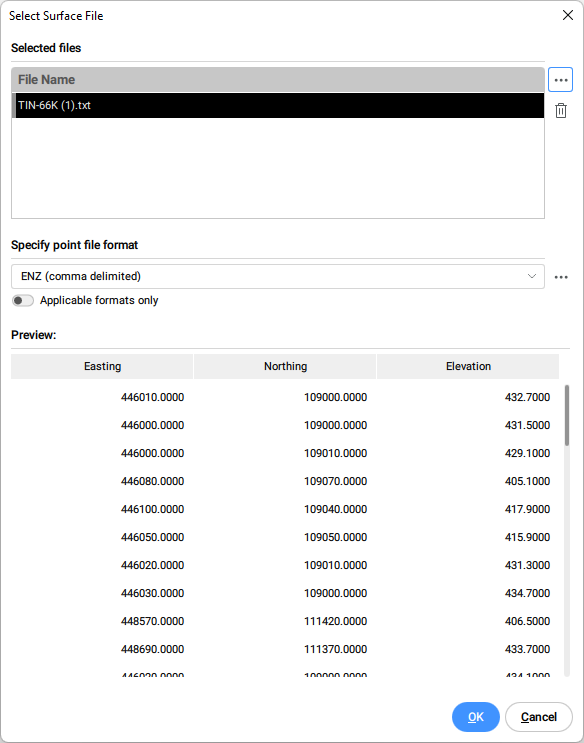

Procedure: Creating a TIN Surface from a point file
- Select Import from file option in the Command line.
- In the Create Surface From Point File dialog box, select the point data file that you want to open, or choose multiple files to import all at once.
- Specify point file format from the drop-down list.Note: Click the browse button in the Specify point file format section to manage surface file formats.
Toggle the Applicable formats only button to automatically filter appropriate point file formats, according to the selected input point file(s).
Click OK to create TIN Surface from a point file.
- Select Nooption in the Command line to create TIN Surface without simplifying points.Note: Check the description of the TIN Simplify algorithm for detailed explanation of the parameters.

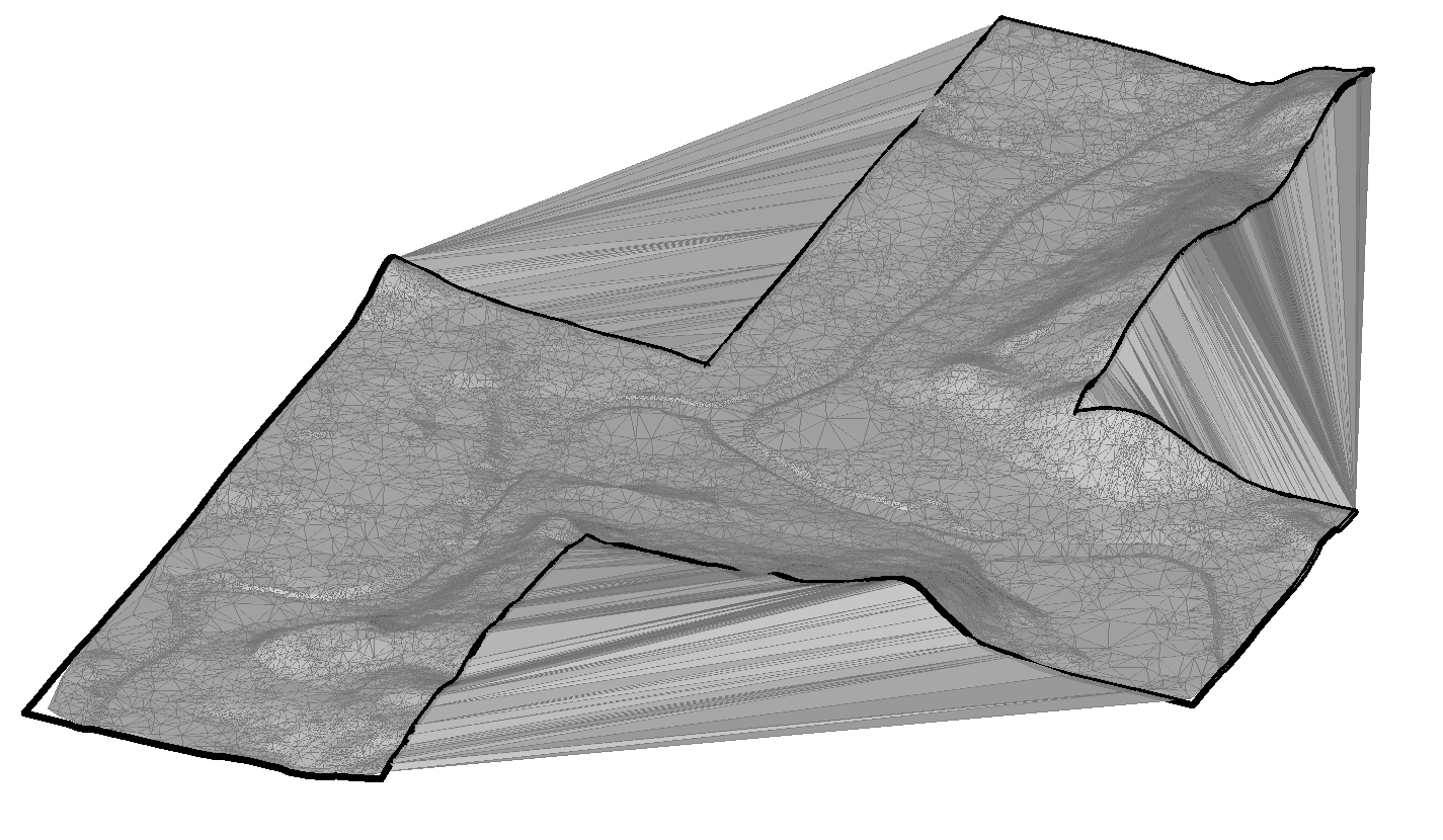

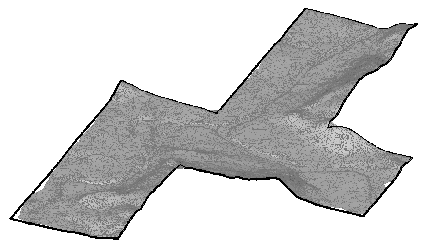

- Follow the procedure for creating a TIN Surface from a point file, which is described in this article.Note: The TIN surface algorithm connects triangles outside the boundary of the concave clipping polygon. In such areas, long and narrow triangles are created, which can be removed with the TINEDIT command.
- Launch the TINEDIT command and select the Remove Outer Edges option. Then specify the maximum triangle length. Triangles that are longer than specified value are removed.

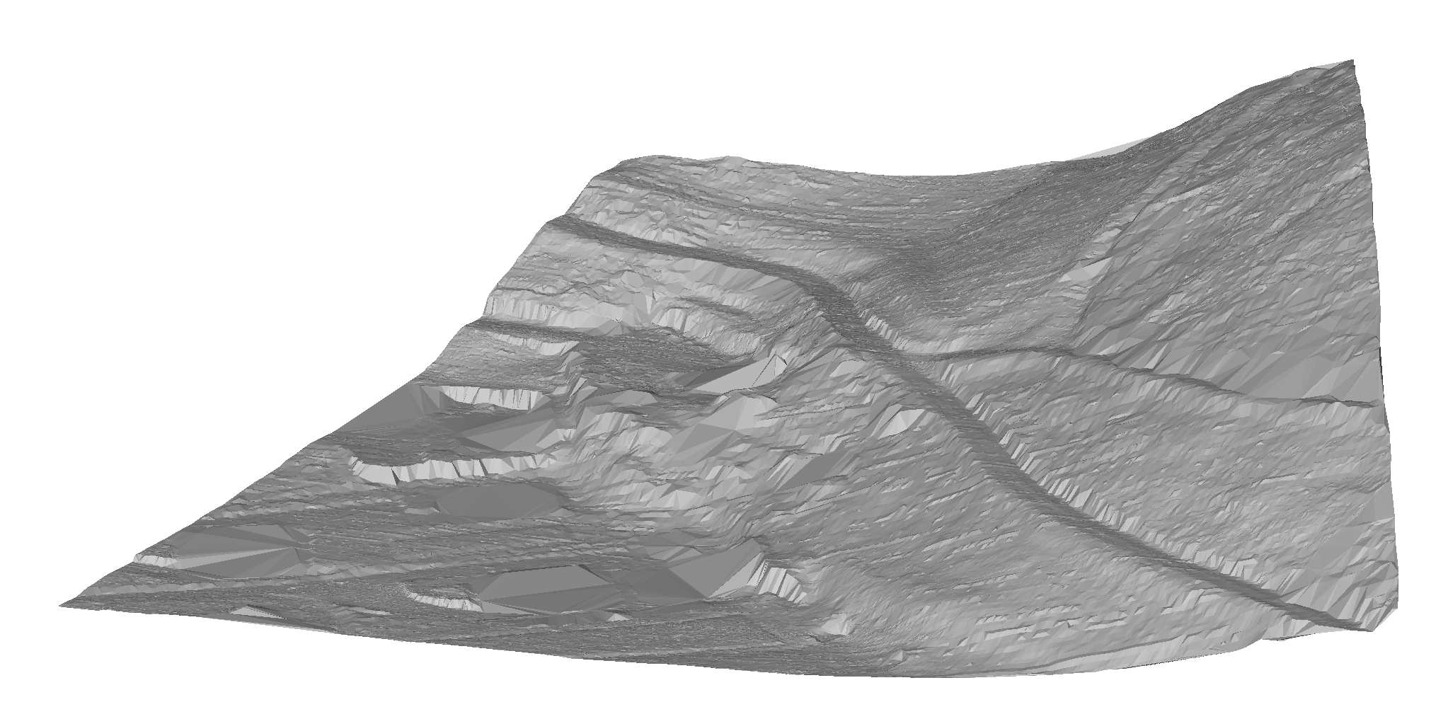

Procedure: Creating a TIN Surface from a Point Cloud
- Open the drawing file that contains a point cloud.
- Select the create from point Cloud option in the Command line.
- Select a point cloud in the drawing.
- Press ENTER.
- Select No to create TIN Surface without using the simplification method.

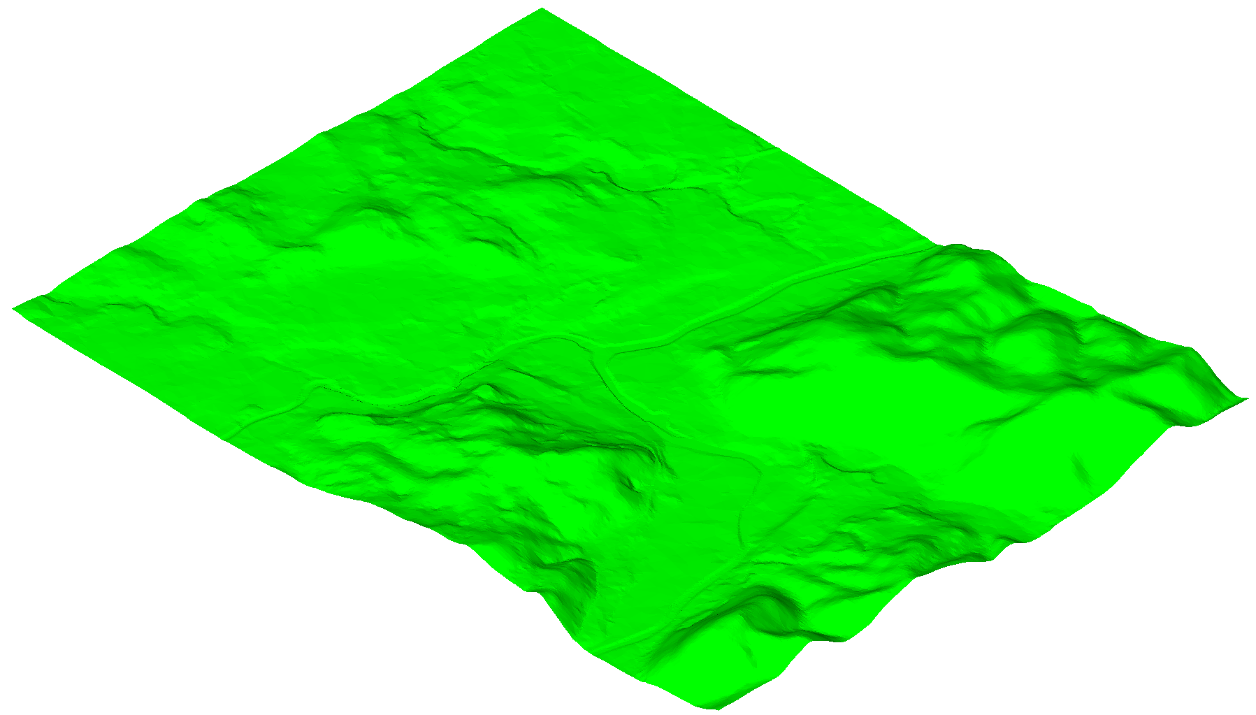

Image shows original TIN Surface created from a Point Cloud with 87350 points.

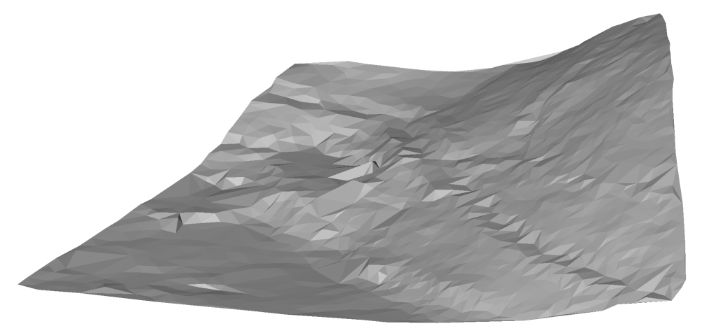

Procedure: Use TIN Simplify and TIN Densify options when creating TIN Surface from a Point Cloud
This section describes the procedure of creating a TIN Surface from a Point Cloud, where we also use the TIN Simplify and TIN Densify options.
Follow steps 1 to 5 from the procedure described above to create a TIN surface from a Point Cloud. Then, follow the procedure below to use TIN Simplify and TIN Densify options.
- Select Yes when command line offers the option to simplify TIN surface.
- Enter radius for simplification step.
- Enter Elevation difference.Note: Check the description of the TIN Simplify algorithm for detailed explanation of the parameters.
- Select the Create tin surface option in the Command line.
Or select the Simplify again option to edit the simplification parameters.

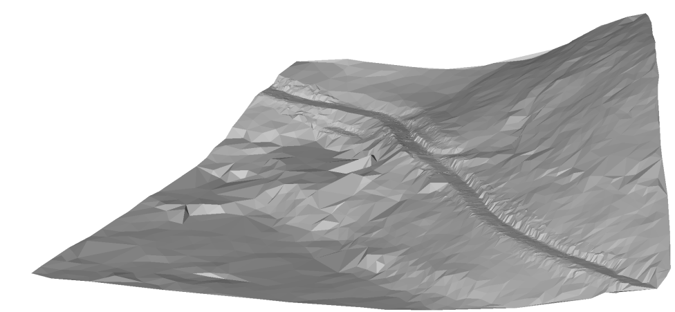

Note: The Command line reports the number of points before and after simplification so that the user can make a better decision for the next steps. - Select Yes to Densify TIN Surface.
Or select No to create simplified TIN Surface.
Image Shows simplified TIN Surface with 1562 points.

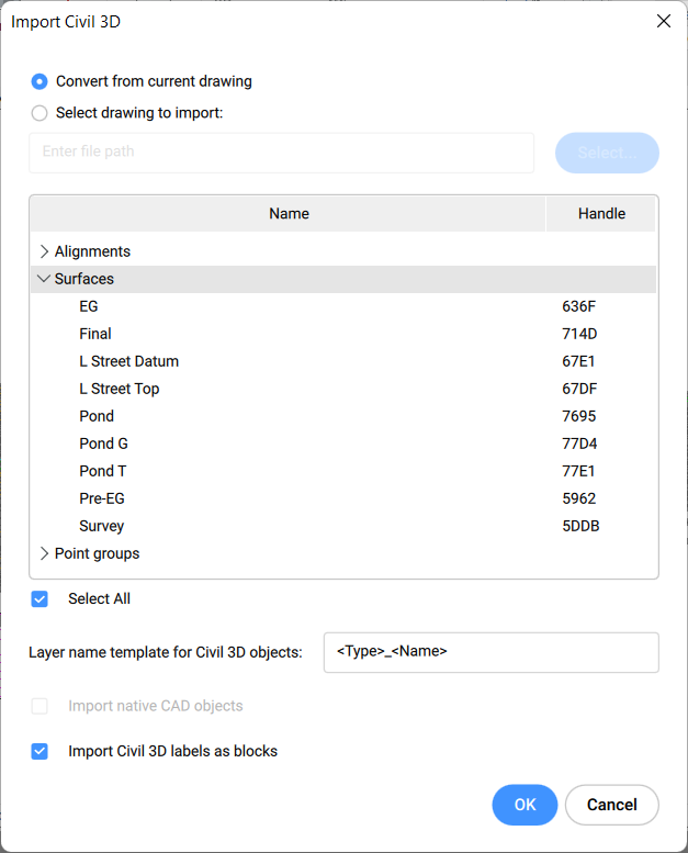

Procedure: Creating a TIN Surface from a Civil 3D surface
- Open a drawing with a Civil 3D surface.
- Launch the CIVIL3DIMPORT command.
- In the Import Civil 3D dialog box, select Convert from current drawing.
Note: Select AutoCAD® Civil 3D Surfaces that will be converted to BricsCAD Civil TIN Surfaces.Note: In the Import Civil 3D dialog box, you can also select other Civil 3D objects, such as Point Groups, Alignments and Profiles, that will be converted to BricsCAD Civil elements.
- Specify the name template for Civil 3D objects.
- Tick the option Import Civil 3D labels as blocks.
- Click the OK button.
- The Create from Civil 3D surface definition is created.

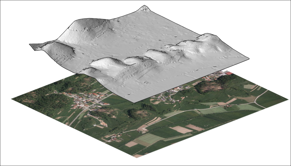

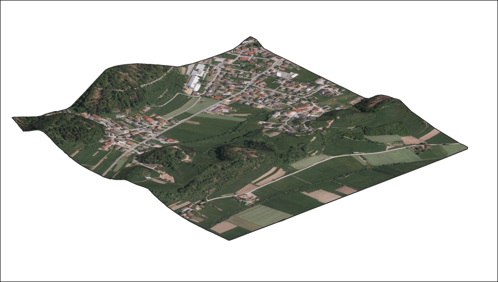

About TIN Assign Image
- Open the drawing file that contains a TIN surface and an image.
- Launch the TINASSIGNIMAGE command.
- Select the TIN surface.
- Select the raster image.Note: If the image is not shown on the TIN surface, change the Visual Style to Modeling or Realistic and set TIN surface triangles to ON.

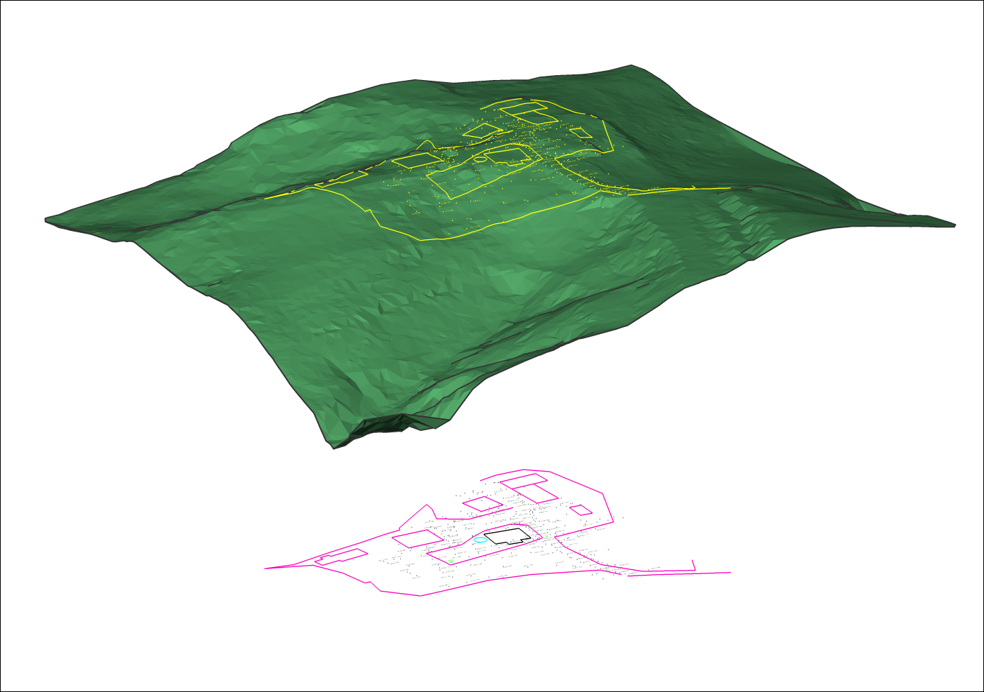

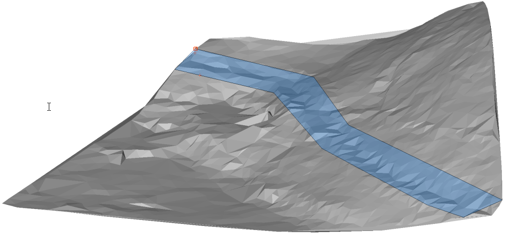

About TIN Project
- Open the drawing file that contains the TIN surface and the entities (points, blocks, text, lines, polylines, circles…).
- Launch the TINPROJECT command.
- Select the entities to project.
- Select if the original entities are to be erased.
