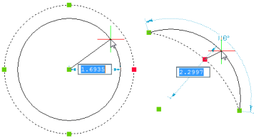

Using dynamic dimensions to grip-edit entities
Select the entity or entities.
All grips on the selected entities display.
Click the grip you want to edit, then move the cursor.
Depending on the value of the DYNDIVIS system variable one, two or all dynamic dimensions display simultaneously .
The first dynamic dimension highlights.
- Do one of the following:
Type the desired value for the currently highlighted dynamic dimension, then press the TAB key to jump to the next dynamic dimension.
The dynamic dimension is locked and displays in red.
Type the desired value for the currently highlighted dynamic dimension, then press Enter to stop.
Press the TAB key to jump to the next dynamic dimension.
- Repeat step 3 or press Enter to stop.

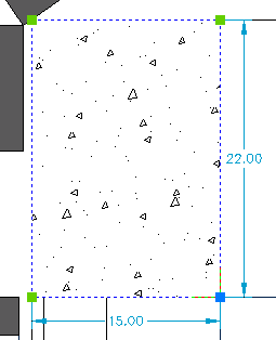

Using dynamic dimensions to measure entities
The following procedure applies to the 2DWireframe visual style only.
Hover the cursor over a grip.
The grip highlights and all dimensions related to the selected grip display.
Dynamic dimensions used to measure a rectangle
Dynamic dimensions used to measure a line
- (option) Click to start editing the selected grip.
