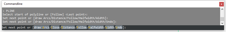

The Command line can either be docked or floating.
By default, the Command line is docked at the bottom of the BricsCAD application window.
To modify the height of the Command line:
  1. Place the cursor over the top edge of the Command line.
  2. Press and hold the left mouse button when a double arrow appears.
  3. Move the mouse.
Click the Close (x) button to close the Command line.
Move the cursor over the dotted left hand side, then press and hold the left mouse button to make the Command line floating.

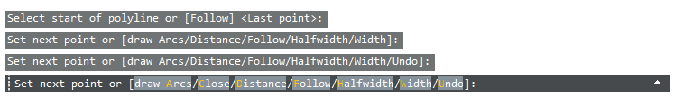

When the Command line is floating, set the value of the CMDLINEUSEMINIFRAME (command line use new floating frame) system variable = 1 to minimize the Command line to a single line. When executing a command, a number of prompt lines are displayed temporarily and transparently on the graphic screen:
The number of prompt lines is set by the CLIPROMPTLINES system variable.
Click the up arrow at the right hand side to display the Command History window.
When you move the Command line mini-frame near the bottom of the graphic screen, it will stick there.
