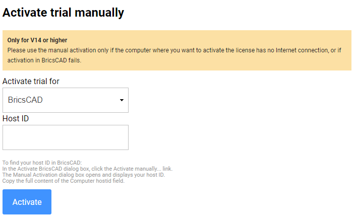

  7. Choose Activate BricsCAD Trial manually.
  8. In the Host ID field, paste the computer host ID of the computer you want to install BricsCAD on and click the Activate button.
    A license file is generated and made available for download.
  9. Click the Download License File button.
