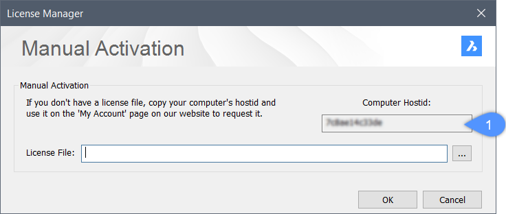

  2. Click the Activate license button in the BricsCAD dialog box.
  3. Click Activate manually... in the License Manager > Activate BricsCAD dialog box.
    The License Manager > Manual Activation dialog box opens.
  4. Copy the full content of the Computer Hostid (1) field.

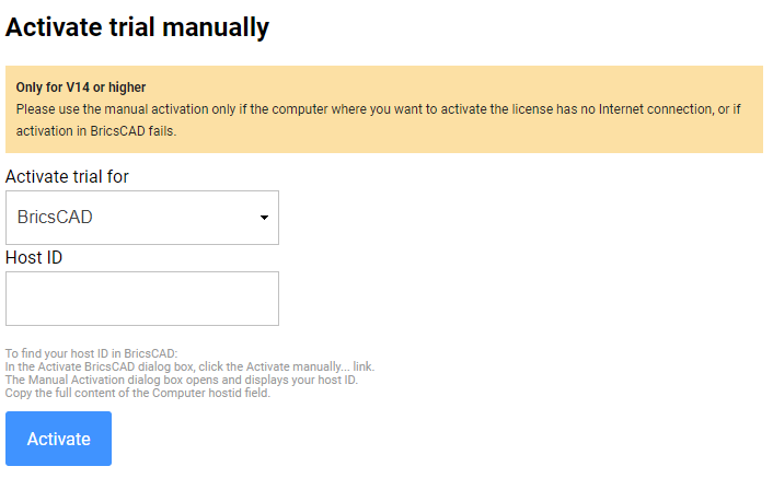

  5. Log in to the Bricsys website with the computer connected to internet.
  6. Click your user name and select Manage licenses (2) in the drop-down menu.
  7. Choose Activate BricsCAD Trial manually.
  8. In the Host ID field, paste the computer host ID of the computer you want to install BricsCAD® on and click the Activate button.

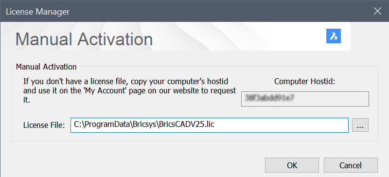

  10. In the License Manager > Manual Activation dialog box, click the Browse button ().
  11. Open the folder where you copied the license file to and select the file.
  12. Click the OK button.
    BricsCAD® is launched.
