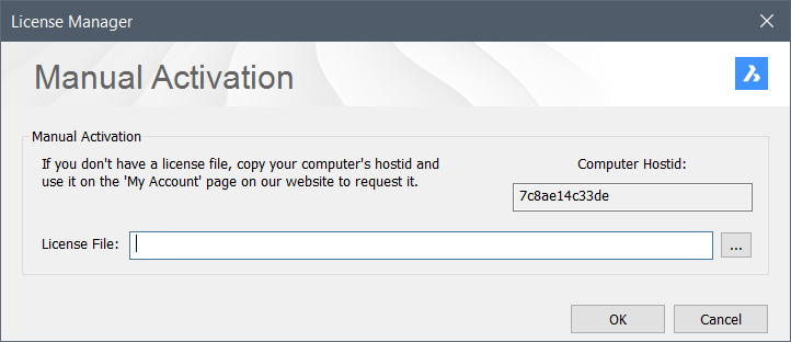

  2. Click the Activate license button in the BricsCAD dialog box.
  3. Click Activate manually... in the License Manager > Activate BricsCAD dialog box.
    The License Manager > Manual Activation dialog box opens.

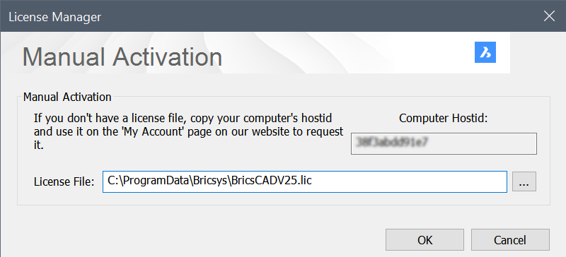

  4. Copy the full content of the Computer Hostid field.

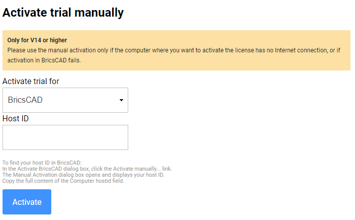

  5. Log in to the BricsCAD website with the computer connected to internet.
  6. Click your user name and select Manage licenses in the drop-down menu.
  7. Choose Activate BricsCAD Trial manually.
  8. In the Host ID field, paste the computer host ID of the computer you want to install BricsCAD on and click the Activate button.
    A license file is generated and made available for download.
  9. Click the Download License File button.
    The license file is downloaded to your default download folder.
  10. In the License Manager > Manual Activation dialog box, click the Browse button ().
  11. Open the folder where you copied the license file to and select the file.
  12. Click the OK button.
