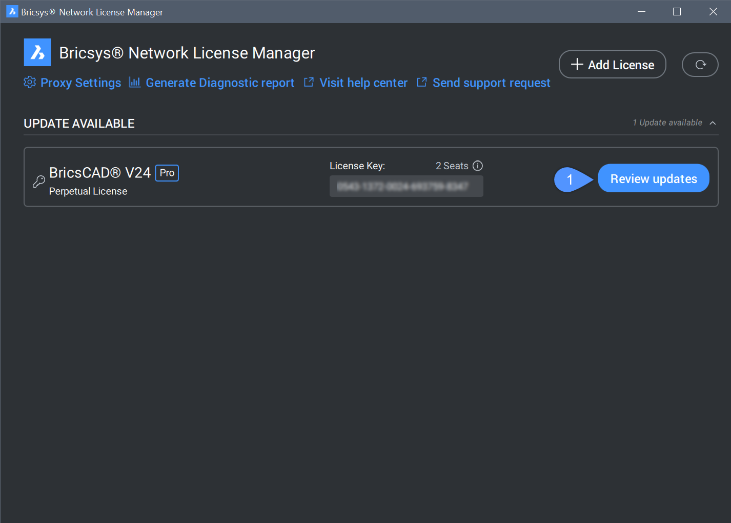

  • The active licenses are kept and displayed in the new Bricsys Network License Manager dialog box.
All licenses under maintenance, where you are entitled to a version upgrade, are shown under the Update available category.

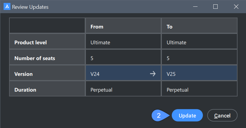

Click the Review updates button (1) to open the Review Updates dialog box to have an overview of which updates are available for that license.
Click the Update button (2) to update the license on your Network License Server.
Note: If the Bricsys Network License Manager dialog box was already open, you might need to click the refresh button () to have the Review updates button available.
