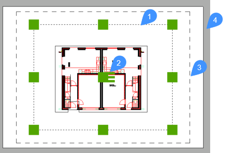

Displaying the paper sheet and the printable area
  1. Viewport.
  2. Viewport Scale button is located near the center of the selected viewport. Click the button to set the Standard scale value from the drop-down list.
  3. Printable area.
    The display of the printable area is controlled through the DISPPAPERMARGINS system variable.
  4. Paper sheet.
    The display of the paper sheet is controlled through the DISPPAPERBKG system variable.
