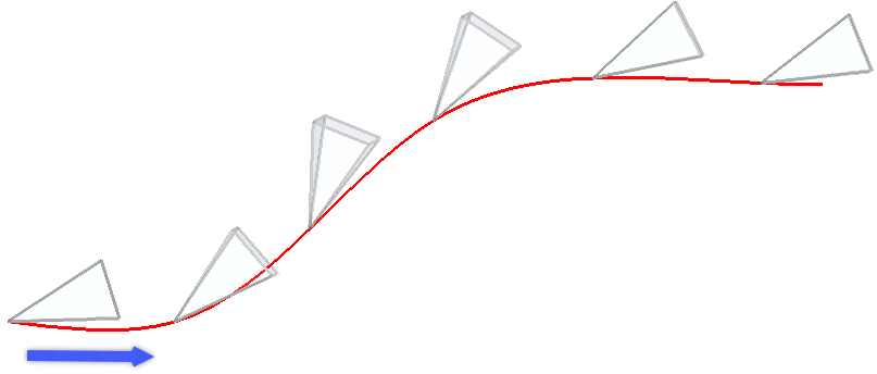

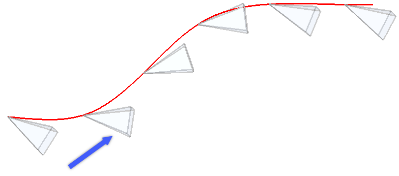

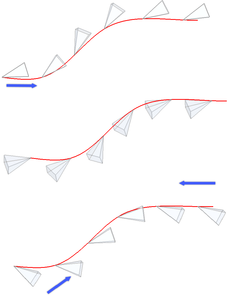

Tangent direction
Determines how the items are aligned relative to the starting direction of the path.
2 Points
Specify two points that define the tangency of the first item relative to the starting direction of the path. Depending on the Align Items setting, the other items are placed parallel to the first item or at the specified tangent direction relative to the direction of the path. In the image Tangent direction - 2 points, the blue arrow indicated the tangency direction.

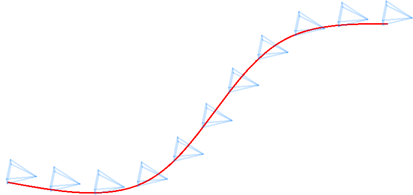

Items
Specifies the number of items or the distance between items, depending on the Method setting.
Enter number of items along path
Places items along the entire path at the specified distance.
Note: Placing items along a portion of the path is possible, by specifying a smaller number.

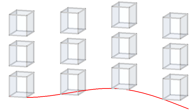

Levels
Creates 3D arrays by specifying the number and spacing of levels.
Distance
Specifies the distance between the bottom and the top level.
Total

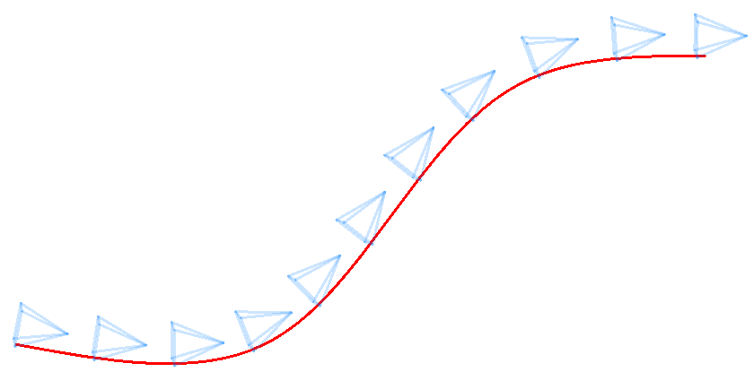

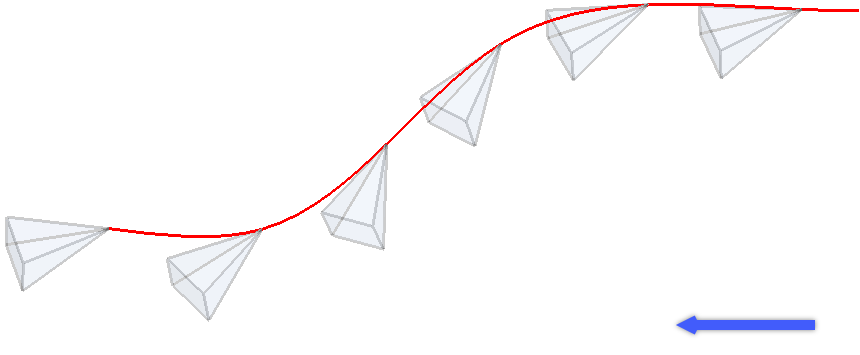

Align items
Specifies whether to align each item tangent to the direction of the path. Alignment is relative to the orientation of the first item.
Yes
Aligns each item to be tangent to the path direction.
No
Each item keeps the orientation of the first item.

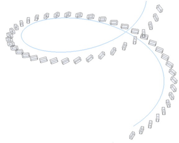

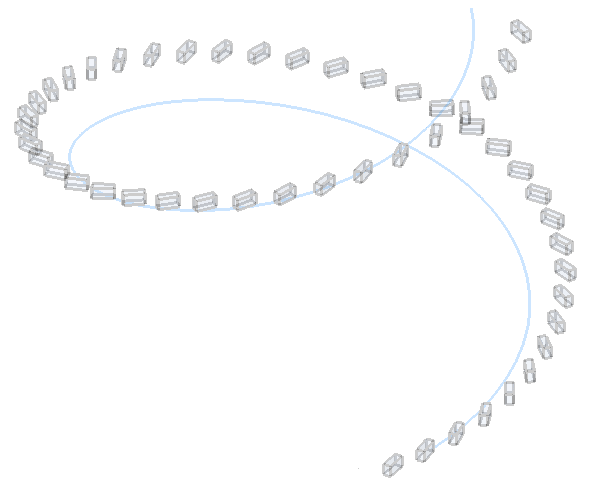

Z direction
Determines whether to maintain the original Z direction of the items or to bank the items naturally along a 3D path.
Yes
Z direction (vertical) is maintained.
No
Items are banked along the helix.
