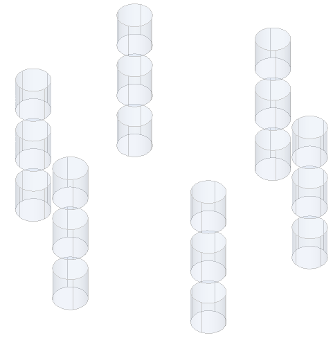

Levels
Creates 3D arrays by specifying the number and spacing of levels.
Distance
Specifies the distance between subsequent levels by typing a value or picking two points.
Total
Specifies the distance between the bottom and the top level.

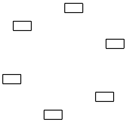

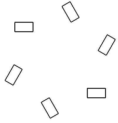

ROTate
Determines whether items are rotated around the circular path or they preserve the orientation of the source entities.
