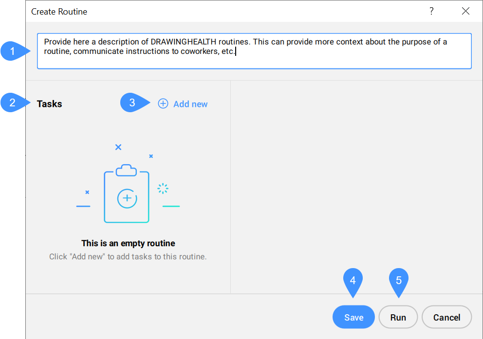

Create Routine dialog box
Opens via: Create new button from the Drawing Health command context panel, which opens with the DRAWINGHEALTH command.
The Create Routine dialog box allows you to define the tasks to be performed within a routine during the DWGHEALTH command.
Allows you to add a description of the Drawing Health routines. This can provide more context about the purpose of a routine, communicate instructions to coworkers, etc.
Tasks
Lists the tasks selected for the current routine to be performed during the DWGHEALTH command.
Note:
  • A working routine requires at least one task.
  • Tasks can be reordered in the routine using drag and drop method.
  • On the right side of the selected task, you can access its settings.
Add new button
Adds new tasks to the current routine from the drop-down list that contains all available tasks.
Note: A task can be added multiple times at different steps of the routine.

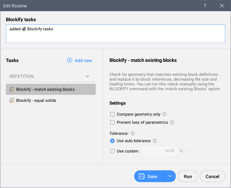

Blockify - match existing blocks
Checks for geometry that matches existing block definitions and replaces it with block references, decreasing file size and loading times, according to the user's preferences. You can run this check manually using the BLOCKIFY command with the match existing Blocks option.
Blockify - equal solids
Replaces equal solids with block references to add structure to the drawing and decreases file size and loading times, according to the user's preferences. You can run this check manually using the BLOCKIFY command with the Equal Solids option.

Save button
Opens the Save Routine dialog box. Type in a name for the created routine.
Run
Allows you to run the created routine under the New Routine* name, without saving it.
Note: The Drawing Health command context panel displays a Save as button after you run an unsaved routine via the Run button in the Create Routine dialog box or Edit Routine dialog box. Click it to open the Save Routine dialog box and save the custom routine with the desired name.
