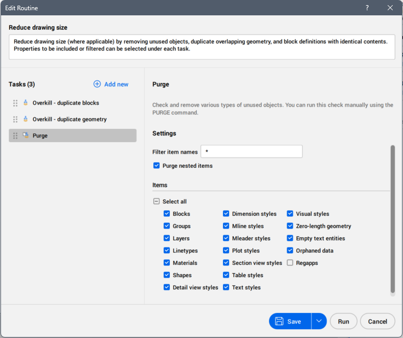

Edit Routine dialog box
Opens via: Edit button from the Drawing Health command context panel, which opens with the DRAWINGHEALTH command.
The Edit Routine dialog box allows you to edit the tasks to be performed within a routine during the DWGHEALTH command.
Routine name
Displays the name of the routine that is being edited.
Routine description
Allows you to add a description of the routine. This can provide more context about the purpose of a routine, communicate instructions to coworkers, etc.
Tasks
Lists the tasks included in the routine to be performed during the DWGHEALTH command.
Note:
  • Tasks can be reordered in the routine using drag and drop method.
  • On the right side of the selected task, you can access its settings.
Add new button
Adds new tasks to the routine from the drop-down list.
Note: A task can be added multiple times at different steps of the routine.
Save
Saves the routine.
Press the arrow from the right to open a drop-down list with two options for saving:
  • Save: saves the routine with the same name.
  • Save as: opens the Save Routine dialog box to save the routine with a different name.
Run
Allows you to run the edited routine under the New Routine* name, without saving it.
Note: The Drawing Health command context panel displays a Save as button after you run an unsaved routine via the Run button in the Create Routine dialog box or Edit Routine dialog box. Click it to open the Save Routine dialog box and save the custom routine with the desired name.
