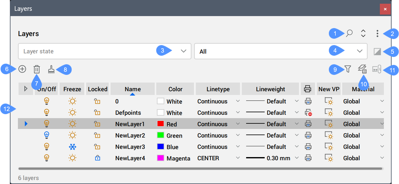

The Layers panel allows you to edit layer names and properties in the current drawing, to create, delete, edit, and switch layers, layer states and layer filters.
  1. Search
  2. Menu
  3. Layer State Control
  4. Filter used
  5. Invert
  6. Add layer
  7. Delete layer
  8. Purge layer
  9. Layer Explorer
  10. Layer States
  11. Hide xref symbols on/off
  12. Layer list
Search
Allows you to search for specific layer names. The list is shortened to display only the layers that contain the entered sequence of characters, regardless of where they are located in the layer name.
Note: To remove the active filter, press the close button on the right side of the search box.
Menu
Hide xref layers
When on, hides layers that came from externally referenced drawings.
Apply layer filter to layer toolbar
When on, shortens the list of layers displayed, according to the conditions of the filter.
When off, displays all layer names.
Indicate layers in use
When on, displays icons in the Current column that indicate whether the layer has entities assigned to it. Unused layers can be purged.
Change the row height of the table view by switching between Compact View, Default View and Comfortable View.
Layer State Control
Displays the current layer state if there are any defined in the drawing. Click the down-arrow button to choose a different layer state.
Filter used
Displays the current layer filter if there are any defined in the drawing. Click the down-arrow button to choose a different layer filter. Some filters are automatically created by BricsCAD: All, All Used Layers.
Invert
Inverts the content of the current filter so that the panel displays all layers not included in the filter.
Add layer
Creates new layer with the generic name NewLayer1. The new layer that is created copies the properties of the currently selected layer.
Delete layer
Deletes selected layers, except for the layer with the name 0 and any layer with entities, which cannot be deleted.
Purge layer
Purges selected layers from the current drawing, except for the following ones, which cannot be purged:
  • The layer 0.
  • The current layer.
  • Any layer with entities.
Layer Explorer
Displays the Drawing Explorer dialog box with the Layers category selected.
Layer States
Displays the Drawing Explorer dialog box with the Layer States category selected.
Allows you to turn on or off the display of XRef layers.
Layer list
Displays a list of layers and their properties. The list can include all layers in the current drawing or a subset of those layers based on selected layer states or filters. Column headers describe the properties of each layer.
Note:
  • To sort the list in either ascending, descending or creation order, click the title in the column heading.
  • To reorder the columns, drag the desired column header to a new position.
  • Right click a column header to display the table context menu options.
    • Columns list: Show or hide a table column by clicking on its name in the list.
    • Show all columns: Shows all table's columns.
    • Restore column positions: Restores the default position of all table's columns.
