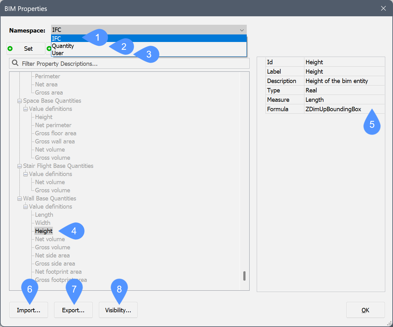

Entities have a set of properties which can be viewed in the Properties Panel. If an entity has been assigned a certain BIM classification or Type (for example Wall or Slab), additional properties will be displayed such as IFC Common properties and Base quantities. Which properties are displayed in the panel is managed in the BIM Properties dialog box, which is opened by the BIMPROPERTIES command.
Namespaces
In the BIM Properties dialog box, by default three namespaces are available: IFC (1), Quantity (2) and User (3). The IFC namespace contains properties that are defined by the IFC2x3 and IFC4 schemes, that are merged automatically in background during IFC Import or Export. This contains both common properties (for example Wall Common properties, such as Fire Rating and Acoustic Rating), and Quantities (for example Wall Quantities > Nominal Height (4)). These Quantities are based on so-called Core quantities (5) of the solid (see Core quantities section of this article).
The Quantity namespace contains some hard-coded quantities of BIM objects also based on the Core quantities, much like in the IFC namespace.
Note: The Quantity namespace is deprecated. It has been replaced by the Quantities in the IFC namespace, however it is still available in the BIM Properties dialog for backward compatibility with versions V20 and older.
The User namespace exists for the user to create their own property definitions. See also the Procedure article Custom Properties for more information on custom properties.
You can export all property sets (properties or quantities) defined in the drawing to an XML file by clicking the Export... button (7) on the bottom left. You can then import this file in another drawing.
The visibility of namespaces or attribute sets can be switched on and off according to your preferences by clicking the Visibility... button (8).
Note: Using this method the namespace will only be imported for this particular project. If you want namespaces to be imported over all your projects, open the Settings dialog and under the BIM > General > Default properties path you can add a new path. By default, it should take you to C:\Program Files\Bricsys\BricsCAD V26 en_US\Support, where you can find for instance the bimproj_IFC.xml file containing the IFC namespace.

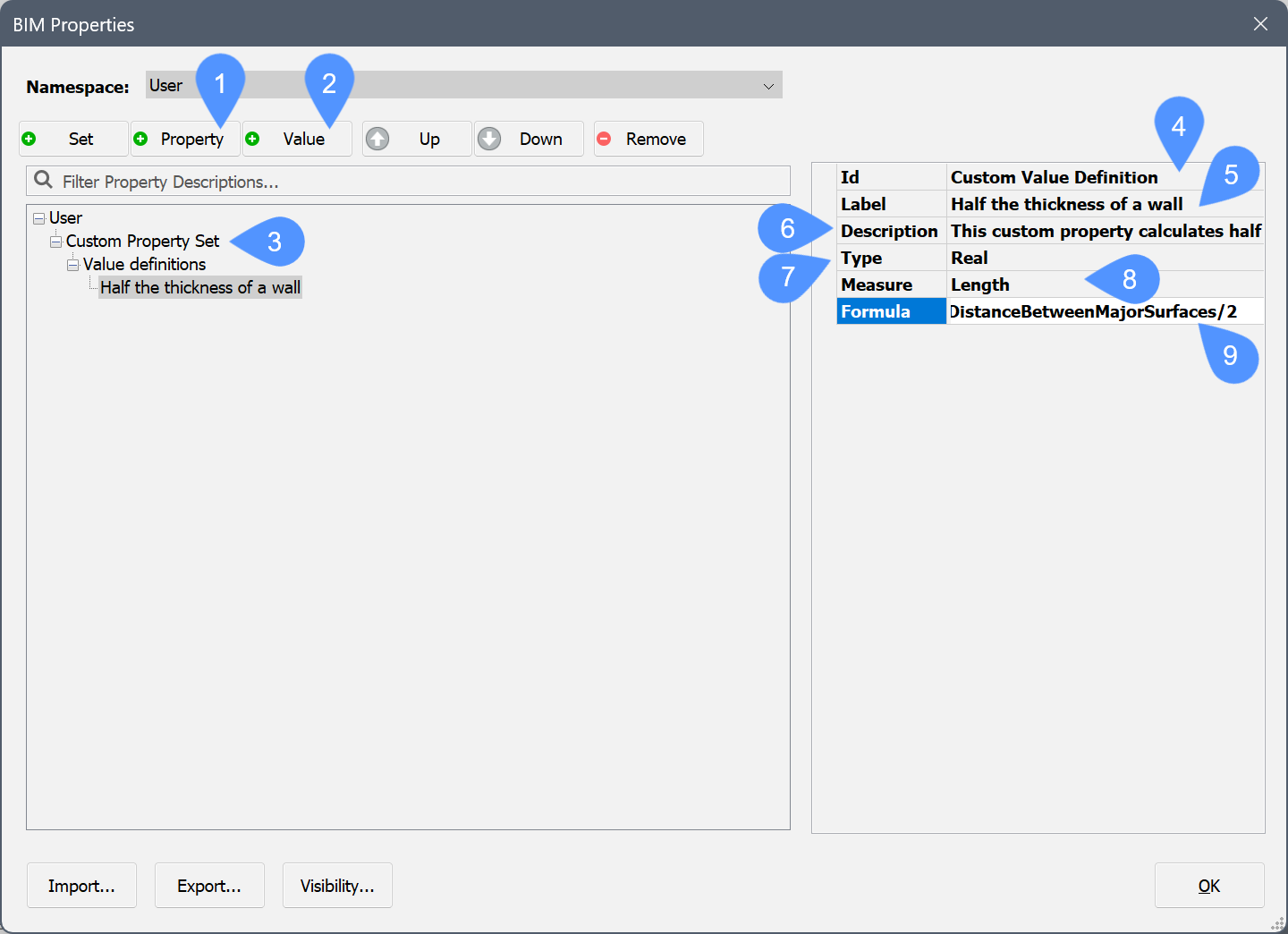

In the User namespace it is possible to create custom properties inside a custom property set using the Property (1) button, see the Procedure article Custom Properties.
It is also possible to create user-defined quantities, using the Value (2) button. In the image below, a user-defined quantity was created in a Custom Property Set (3). This user-defined quantity (or Value Definition) has the following attributes:
  • Id (4): a unique identifier.
  • Label (5): the name of quantity which will show up in the properties panel. This can be the same as the ID, however the ID must be unique.
  • Description (6): a description of the quantity.
  • Type (7): the type of the quantity. Typically, a quantity will be defined as a Real value.
  • Measure (8): the measure of the quantity, that is a length value, an area, volume or mass.
  • Formula (9): the actual expression of the quantity. Here Core quantities can be used, as well as mathematical expressions as defined in the Procedure article Working with Parameters and Constraints.
In this example, a user-defined quantity is defined that displays half the thickness of a wall, which is calculated as DistanceBetweenMajorSurfaces/2.

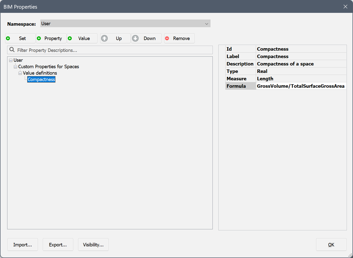

Procedure: creating a user-defined quantity
In this part you will learn how to make user-configurable quantities. By way of example, we will define a quantity of Spatial objects such as a room. The quantity will be the Compactness which can be calculated as the volume of the space divided by the sum of the areas on all sides of the space.

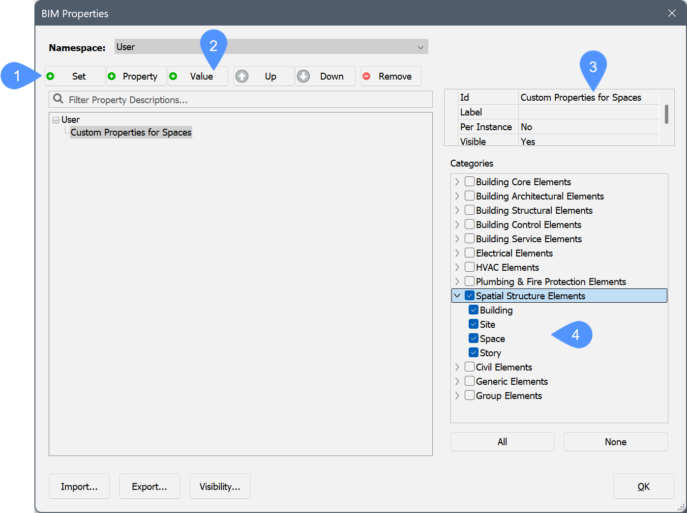

  1. Open the BIM Properties dialog box by typing BIMPROPERTIES in the Command line.
  2. Set the User namespace as current namespace.
  3. Create a new Property Set by clicking the Set button (1), and give it a name (3).
  4. Assign the Property Set to one or more categories (4). In this example we will assign it to spatial elements.
  5. Create a new Value Definition by clicking the Value button (2).
  6. Give this Value Definition an Id and a Label, for example Compactness.
  7. (Optional) Give this Value Definition a description.
  8. Assign the correct Type to this Value Definition. Because our Value Definition will be based on a calculation of two Real values, this will also be a Real value.
  9. Assign a Measure to the Value Definition. Because the result of the calculation will be a volume divided by an area, we will end up with a Length measure.
  10. Fill in an expression in the Formula field. The volume of a space is a Core quantity with the name GrossVolume. The sum of areas of the space on all sides is also a Core quantity with the name TotalSurfaceGrossArea. Hence, we can define the Compactness = GrossVolume/TotalSurfaceGrossArea.
  11. Click OK to close the BIM Properties dialog box.
