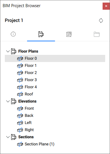

Project browser
  1. In the Sections and views tab of the Project Browser panel, right-click the section.
  2. (Optional) Choose Select Section Entity to change its properties in the Properties panel.
  3. Choose Update Now or Update in Background.
  4. Choose Refresh project in the Project Browser panel.
    A new section is generated in the Sheets segment of the Project Browser.

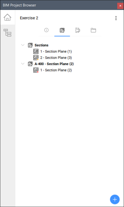

Project browser
To open the 2D section drawings from the Project Browser, do one of the following:
  • Double click the sheet view in the Sheets tab of the Project Browser panel.
    The 2D section drawing opens with the selected sheet view.
  • In the Sections and views tab of the Project Browser panel, right-click the section and choose Display Section Result from the context menu.
Note: When a viewport linked to a section result is deleted, the linked view label, the sheet view and the result block (only when no other viewport views it) are also erased.

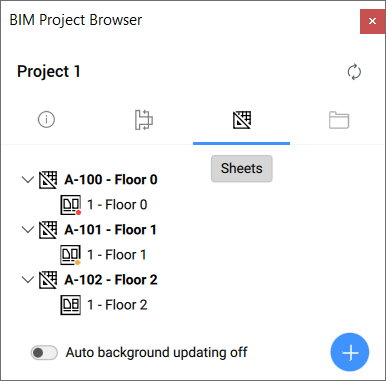

When the 2D documentation is no longer in sync with the 3D model, the corresponding sheet views display a red mark in the Sheets tab of the Project Browser panel.
The sheet views display an orange mark in the Sheets tab of the Project Browser panel if they are not yet updated.

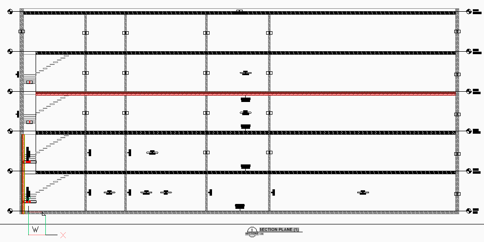

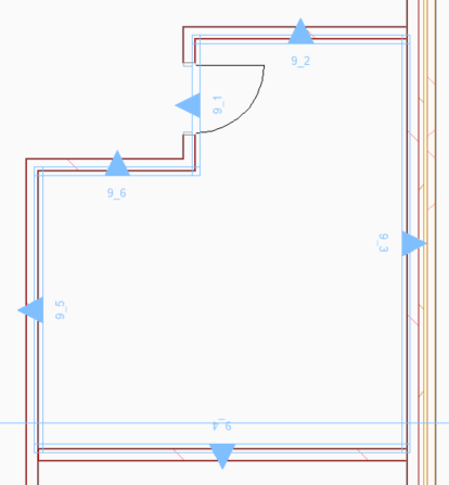

Section indicators, story indicators and grid callouts
Section indicators are provided for any section which intersects with the source one, if the source section is a plan. They are stored on the dedicated BIM_SECTIONS layer. Turn the layer On or Off to manage the indicators visibility.
Note: Section indicators, story indicators and grid callouts are BIM tag entities that can be edited and customized. See the BIM Tags help article.
Story indicators are provided for any non-horizontal section if the model drawing has stories.
Grid callouts are provided if the model drawing has a grid and it's parallel or perpendicular to the source section plane.
