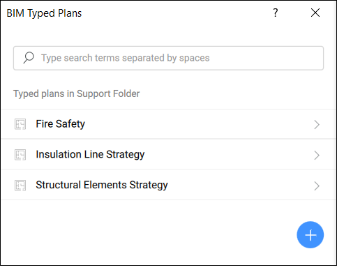

  2. Typed Plans in the support folder cannot be managed from the BIM Project Browser as they don't belong to a project. Use the TYPEDPLANS command to manage them in the BIM Typed Plans dialog box.
  1. To open the BIM Typed Plans dialog box, enter the TYPEDPLANS command in the Command line or click the Typed Plans icon in the Ribbon panel.
  2. Click to create a new template. By default, the template is named New Typed Plan with the text highlighted.
  3. Rename the template while the text is being highlighted. When finished, press Enter to save and apply the name.

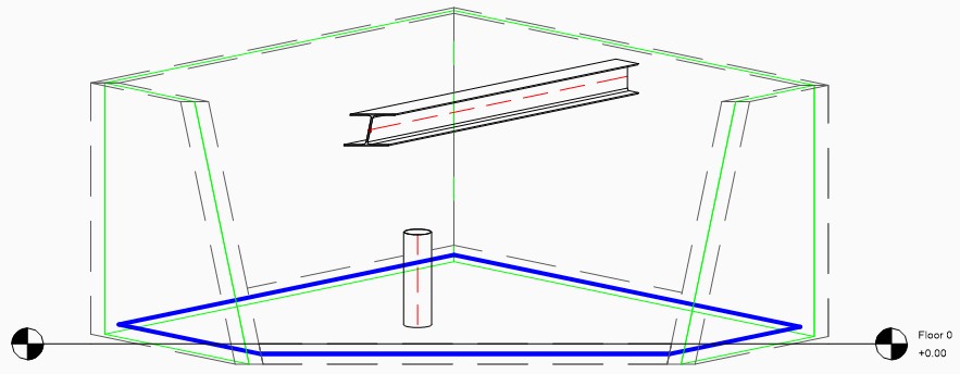

Center Customization determines the appearance of the center of planar or linear entities. The resulting center lines, for example from cutting a wall’s center plane in a floorplan, can be customized.
Center customization is particularly useful in scenarios where you would like to display the center elements of various planar and/or linear entities. For example, if you were to apply the center customization settings against a planar entity, for example a wall, you would be referring to the display behavior of its center plane. However, if you were to apply the same settings against a linear entity, for example a beam, you would be adjusting how the beam's center line appears on the sheet.
The diagram above illustrates an example of how the center elements differ between planar (wall center plane highlighted in green; slab center plane highlighted in blue) and linear entities (both column and beam center lines in dashed red lines).
There is no default setting to adjust the visibility of these center elements, and they are not normally displayed in section results.

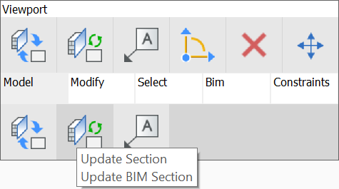

  4. Once done, hover over your selected viewport to access the Quad. Click Update Section in the Quad under Model tab.
  5. You should see a refreshed Viewport with the graphical changes as per your Typed Plans settings.
