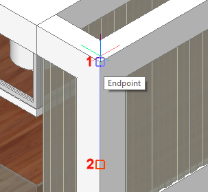

Defining the 2D Entity Snap system variables
Right click the ESNAP field in the Status bar then choose settings in the context menu. The Settings dialog box displays with the 2D and 3D entity snaps settings expanded.
2D Entity Snap options
Icon | Description |
Sets the OSNAPZ system variable to Ignore entity snap elevation, replacing the Z coordinate of the snapped point with the current value of the ELEVATION system variable.![]() The 3d snap marker (1) displays the identified 3d point, the snap marker (2) displays at the current Elevation height. |
Disables the Ignore hatches option of the OSOPTIONS system variable, thus allowing to snap to hatches. |
Disables the Entity snap to negative-z option of the OSOPTIONS system variable, thus allowing entity snaps with a negative z-value when a Dynamic UCS is active. |
Disables the Ignore endpoints of dimension extension lines option of the OSOPTIONS system variable, thus allowing entity snaps to dimension extension lines. |
Sets the OSOPTIONS system variable to ignore invisible geometry in shaded and hidden-line views. |

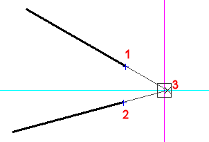

Snapping to the extension of two entities
- If not already on, turn on the Extension Entity Snap mode.
- Launch an entity creation command, for example LINE.
- Move the cursor over the endpoint of the first entity (1).
A small red cross indicates the entity is marked for extension.
- Move the cursor over the endpoint of the second entity (2).
- Move the cursor near the intersection of the extensions of the two entities.
An X indicates the intersection (3).
- Click to accept the snap point.
