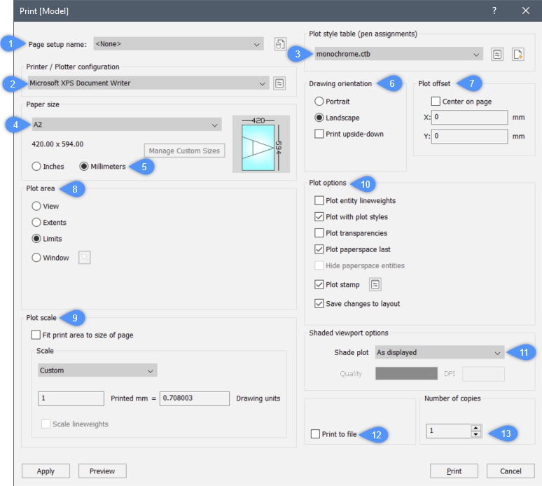

A standard print procedure consists of the following steps:
  • Choose either a Layout tab or the Model tab.
  • Open the Print dialog box.
  • Select a Page Setup name. (1)
The following steps are optional and only necessary if you want to use overrides on the selected page setup definition:
  • Choose a Printer or Plotter configuration. (2)
  • Choose a Plot style table. (3)
  • Choose a Paper size. (4)
    The image reflects the position and orientation of the drawing on the selected paper size.
  • Choose the paper size unit. (5)
  • Choose the Drawing orientation.(6)
  • Define the Plot offset. (7)
  • Specify the Plot area (the area to plot). (8)
  • Define the Plot scale. (9)
  • Check the Plot options. (10)
  • When printing model space, choose a Shade plot mode. (11)
    This option is disabled when printing a paper space layout.
  • Check/uncheck the Print to file option. (12)
  • Specify the Number of copies. (13)
  • Click the Preview button to see a preview of the plot output.
  • When in a layout, click the Apply button to update the layout.
  • Click the Print button to start printing.

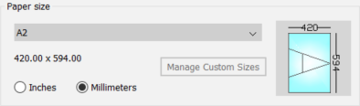

Choosing the paper size
Press the down arrow, then select the paper size in the Paper Size list.
The available sizes depend on the selected printer.
Choosing the paper unit
Select either Inches or Millimeters.
The paper size image indicates the size, position and orientation of the plot area on the selected paper size.
Note: The Scale and Plot offset setting units are changed according to the chosen Paper unit.

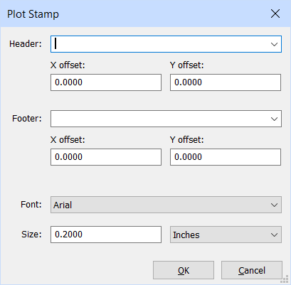

Defining the plot stamp
  1. Click the Edit plot stamp button.
    The Plot stamp dialog box appears.
  2. In the Header field, do one of the following:
    • Type the header text.
    • Click the down arrow button, then choose a variable in the drop down list.
    • Type one or more variable names (see table below).
    • Leave the field empty.
  3. Define the X and Y offset for the header.
  4. In the Footer field, do one of the following:
    • Type the footer text.
  5. Define the X and Y offset for the footer.
  6. Select a font in the Font list button.
  7. Enter a value in the Font Size field.
  8. Set the unit type to Millimeters or Inches.
  9. Click the OK button to save the plot stamp.
Variable Name Description
$Name Adds the value assigned to the RegisteredOwner from the Windows registry.
Note: User must add the new key as String Values into Windows registry: Computer\HKEY_LOCAL_MACHINE\SOFTWARE\Bricsys\RegisteredOwner
$Company Adds the value of the RegisteredOrganization from the Windows registry.
$Date Adds the current date.
$DateTime Adds the current date and time.
$DwgName Adds the file name and path of the drawing.
Note:
  • The header and footer text consists of three parts (left, center and right), separated by commas.
  • By default, the header and footer text is centered.
  • The header and footer text can be outlined left center and/or right by separating the text with commas.
    For example: $Name,$Company,$Date places your name left, company name centered and the current date at the right.
  • Type a space before one of the commas to leave one of the parts empty, thus outlining the header or footer left or right.
    For example: $Company, , ($Company,<space>,<space>) outlines the company name left. , ,$Company (<space>,<space>,$Company) outlines the company name right.
  • The plot stamp settings are saved to a series of user preferences in the current user profile, which can be edited in the Settings dialog box under Program Options > Plot and publish > Plot Stamp.
