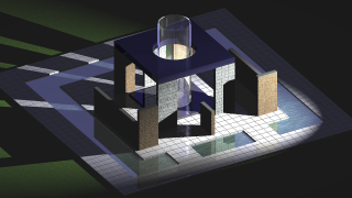

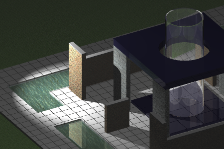

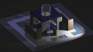

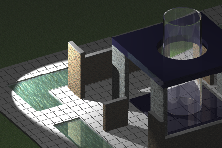

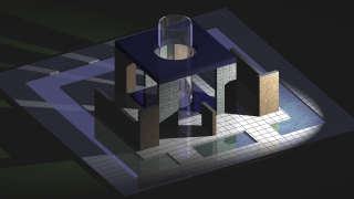

Spotlight hotspot and falloff properties
When a surface is illuminated by a spotlight, there is an area of maximum illumination (hotspot = 1) that is surrounded by an area of lesser intensity (falloff = 2).
Hotspot angle: angle of the central light cone (defines the hotspot)
Falloff angle: angle of the full light cone
| Hotspot angle = 55, Falloff angle = 60 | Hotspot angle = 30, Falloff angle = 60 |
The difference between the hotspot angle and the falloff angle defines the area of lesser light intensity.
If the falloff angle and the hotspot angle are almost equal the edge of light cone is rather sharp (left).
The greater the difference between both angles, the softer the edge of the light cone (right).
