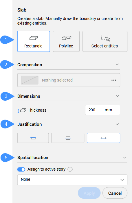

Options within the command context panel
  1. Creation mode
  2. Composition
  3. Dimensions
  4. Justification
  5. Spatial location
Creation mode
Allows you to choose a method for creating the slab.
Rectangular
Defines the new slab boundary by manually drawing a rectangle.
Polyline
Defines the new slab boundary by manually drawing a polyline.
Select entities
Allows you to select an entity from the drawing to define the new slab boundary. You can select either a single 2D curve/region/boundary, or multiple walls. When these entities are preselected before launching the BIMSLAB command, the panel automatically selects this mode.
Composition
Opens the Compositions dialog box that lets you define the current slab composition. By default the compositions of type Slab are shown. You can change this filter in the Compositions dialog box.
Dimensions
Thickness
Sets the slab thickness.
Note: When a composition with a fixed thickness is selected, this parameter is greyed out.
Justification
There are three justification options: top, center and bottom. By default, the justification is set to bottom. To change it, click another justification option.
Spatial location
Allows you to select a spatial location from the drop-down menu to assign to the slab.
Assign to active story
Allows you to copy the spatial location of the active story which is currently active in TVM or of the closest story level if not in TVM.
