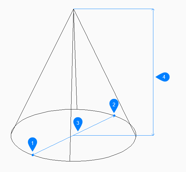

  1. Center
  2. Diameter
  3. Radius
  4. Height

Diameter
Allows you to specify the diameter of the cone’s base.

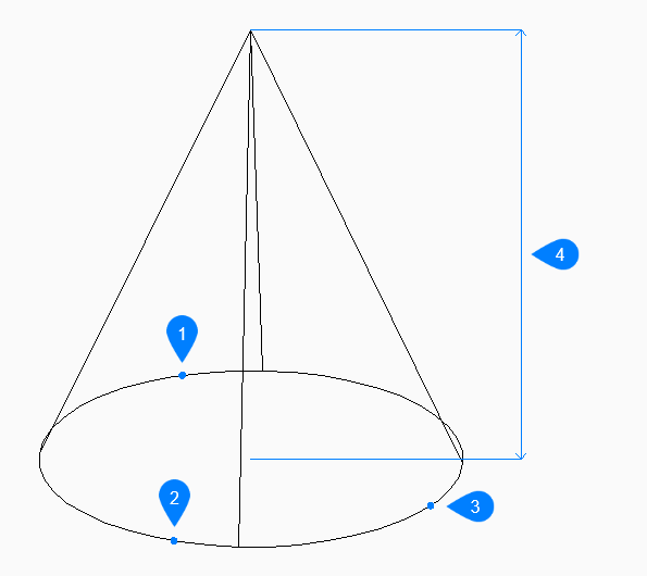

3Point
Allows you to begin creating a circular cone by specifying three points on the circumference of its base.
First point
Specifies the first point on the circumference.
Second point
Specifies the second point on the circumference.
Third point
Specifies the third point on the circumference.
  1. Point 1
  2. Point 2
  3. Point 3
  4. Height

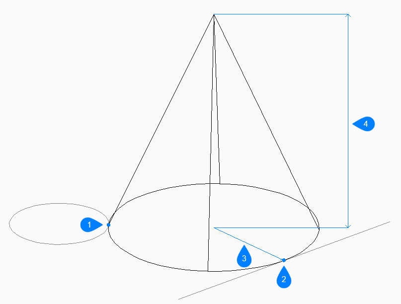

Tangent Tangent Radius
Allows you to begin creating a circular cone by selecting a tangent point on the first and second entity.
Specify point on object for first tangent
Allows you to select a tangent point on the first entity.
Specify point on object for second tangent
Allows you to select a tangent point on the second entity.
Radius of circle
Allows you to specify a valid radius for the base.
Note: If you specify a radius that is not possible with the selected tangents, you are prompted to specify the tangents and radius again.
  1. Tangent point 1
  2. Tangent point 2
  3. Radius
  4. Height

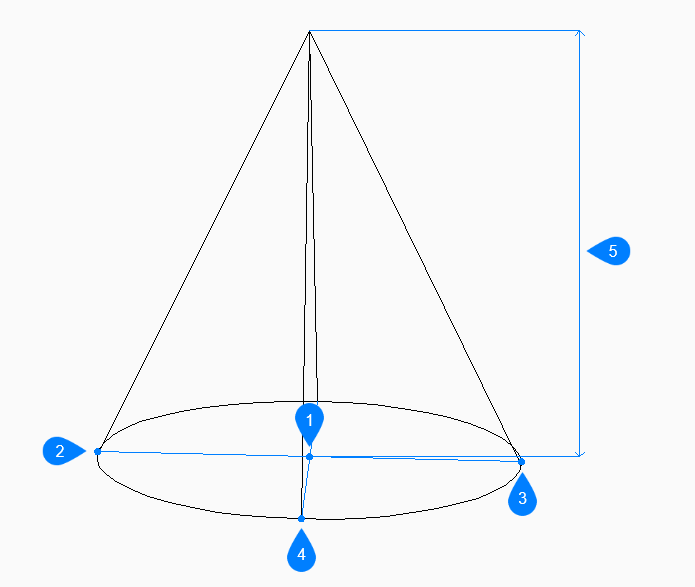

Elliptical
Allows you to begin creating an elliptical cone by specifying the first end, second end and the other end of the ellipse axis.
Set first end of ellipse
Specifies the first end of the ellipse axis.
Second end of ellipse axis
Specifies the second end of the ellipse axis.
Other end of ellipse axis
Specifies the radius of the other ellipse axis.
  1. Center
  2. First end of ellipse axis
  3. Second end of ellipse axis
  4. End of other axis
  5. Height

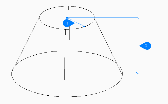

Top radius
Specify a radius for the top of the cone. Any radius larger than zero (0) creates a cone with a flat top.
  1. Top radius
  2. Height
