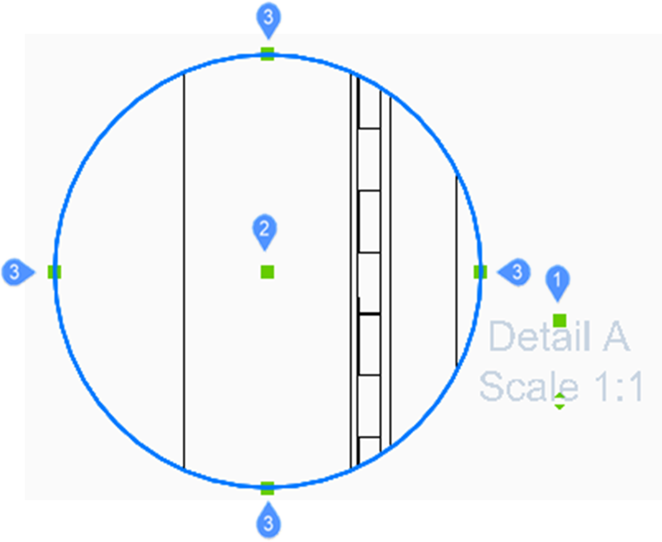

Grips Editing
Detail views can be edited through grips. Select the view. Six grips display.
  1. Controls the position of the identifier.
  2. Controls the position of the section detail.
  3. 4 grips control the size of the detail boundary.
