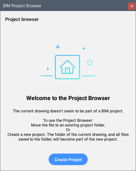

BIM Project Browser panel
To open the BIM Project Browser panel, right-click a ribbon panel or toolbar and choose BIM Project Browser from the Panels list.
The BIM Project Browser panel offers a central location to manage all files and views in your BIM project.
Once a new drawing is saved, you can press the Create Project button.
Note: When starting BricsCAD BIM, you can also create a new project from the Start tab by pressing the New project button.
When you save the new drawing in an existing project folder, the BIM Project Browser displays the Add to Project button. Click it to add the drawing and all the necessary files to the project folder.
During project creation, some files are automatically generated in the project folder, such as a sheetset file (DST), a database file (BSYSLIB) and a default sheet template (DWT). A new subfolder for the sheet templates is generated as well. Other files can be added manually to the project folder or can be generated later on.
Note: The folder in which the active drawing is stored becomes the project folder. All other files and subfolders of this folder will be considered part of this project.

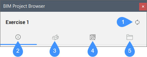

The BIM Project Browser panel consists of four tabs and a refresh button.
  1. Refresh project
  2. Info tab
  3. Sections and views tab
  4. Sheets tab
  5. Files tab

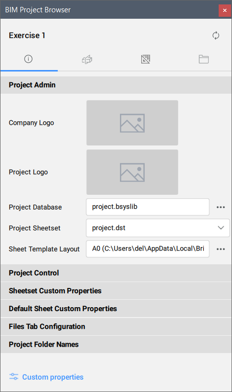

Info tab
Offers a complete overview of the current project.
Project Admin
Shows and sets the:
  • Company Logo: click the thumbnail to select a PNG file. A copy will be made in the project folder and will be renamed 'project.png'. For example, this can be used in a title block.
    Note: The company logo will automatically update in the sheet views of the currently open sheet drawings after saving the open sheet drawings.
  • Project Logo: click the thumbnail to select a PNG file. A copy will be made in the project folder and will be renamed 'project.png'. For example, this can be used in a title block.
  • Project Database: click the browse button () to open the Project Database dialog box that gives a complete overview of the project's drawings and their stored and found database paths. The dialog box allows you to select another project database or to rename the current one. It also supports connecting the listed drawings to the project database.
  • Project Sheetset: displays the current sheet set. Click the drop-down arrow to select an available sheet set from the list.
  • Sheet Template Layout: click the browse button () to open the Select Layout dialog box where you can select the template drawing file path and a layout from the template file.
Project Control
Sets and shows the sheet set properties:
  • Project Name
  • Project Number
  • Project Phase
  • Project Milestone
Sheetset Custom Properties
Sets and shows the sheet set properties defined by the user (for example, Client City, Client Name, Client State, Client Street, Project City, Project State, Project Street).
Default Sheet Custom Properties
Sets and shows the sheet properties defined by the user (for example, Checked By, Drawn By).
Files Tab Configuration
Defines the folders and extensions to ignore. It allows you to specify what part of the project you want to see in the Files tab.
Project Folder Names
Sets the names of the project folders for components, details, images and schedules.
Custom properties
Opens the Custom Properties dialog box where Sheet Set and Sheets custom properties can be added, edited or deleted.

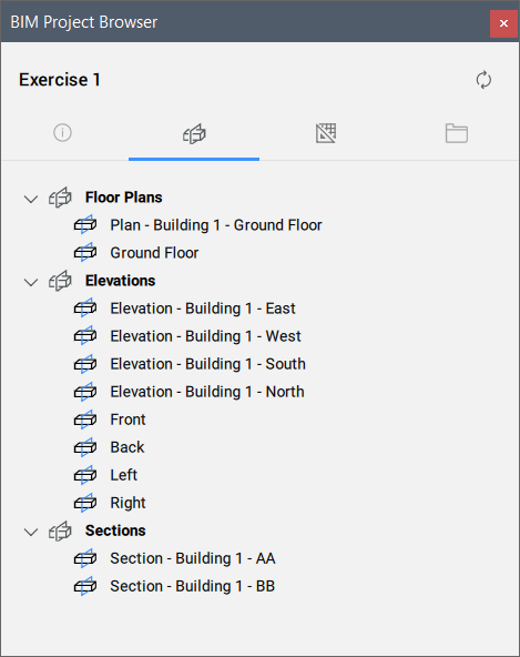

Displays a list of project sections organized by type. You can expand a section type to see its sections.
Right-click a Section to display the context menu:
  • Select Section Entity: selects the section entity in the project model drawing.
    Note: This can also be done by double clicking the section entity.
  • Rename: renames the section entity.
  • Display Section Result: displays the section result in the corresponding sheet and zooms in on its viewport. If not already open, the drawing is opened.
  • Create Sheets: opens the Create Sheets dialog box that allows you to set the viewports and settings of the new sheet.
    Note:
    • If a sheet is already created for the selected section, a notification pop-up appears indicating the name of the sheet. This sheet can be edited in the panel's Sheets tab. Double click it or select the Edit Sheets option from the sheet's context menu.
    • The BIM project data is initialized with an XML file that you can edit.
  • Update Now: regenerates the section result.
  • Update in Background: regenerates the section result in background, without interrupting the user workflow.
Note: You can place sections (single or multiple items selection) or 3D views (single item selection) on an active sheet's Paper Space by dragging items from the Sections and views tab tree and dropping them to that sheet's Paper Space:
  • For single item selection, specify the insertion point. When placing a 3D view, right-click before specifying the insertion point to display a context menu that allows you to select the viewport scale.
  • For multiple items selection, specify first the insertion point, then the second point of a rectangle that defines how the items are arranged (how many rows and columns).

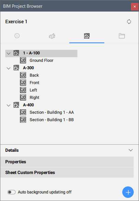

Sheets tab
Displays the contents of the project's sheetset. You can expand a sheet name to see its sheet views.
Note:
  • Double clicking a sheet opens the sheet drawing.
  • You can move a sheet view from one sheet to another by dragging and dropping it above the sheet's name. You can hold down the Ctrl key to drag a copy of that sheet view.
Details
Click the section name to expand it. The section will display the relevant properties for the selected items in the tab. If not grayed out, you can edit these properties.
Auto background updating
Updates the section results automatically, without interrupting your workflow. Turns on or off the ENABLEBIMBKUPDATE system variable.
Add button
By pressing the Add button the below options are available:
  • New Sheet: opens the New Sheet(s) dialog box which allows you to add a new sheet to the Sheets tab or to the currently selected subset, if any.
  • New Subset: adds a new subset to the Sheets tab or to the currently selected subset, if any.

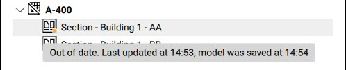

Status of the sheet views:
  • : the sheet view is updated.
    Note: Hover over the sheet view to display a tooltip explaining the status and indicating the time the section was last updated.
  • : the sheet view is background updated.
    Note: Hover over the sheet view to display a tooltip explaining the status.
  • : the sheet view is out of date.
    Note: Hover over the sheet view to display a tooltip explaining the status, the time the section result block was last updated, and the time the model was saved. In this way you can check whether the save time of the model is more recent than the update time of the sheet view.
  • : the sheet view has an error.

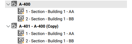

  • Copy Sheet: makes a copy of the sheet DWG file and the sheet entry in the sheetset (under the same subset). All blocks, viewports, named views and sheet views will be copied as well. The naming and numbering of the copied sheet will be handled automatically.

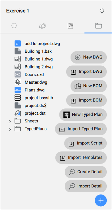

Files tab
Shows the contents of the project folder and allows you to place all supported files (by drag and drop) on an active drawing.
  • Drawings (models, sheets, underlays, etc.)
  • Schedules, scripts, etc.
  • Images:
    • Company logos, googlemap images, site photos, etc.
    • PNG created by script based on named views.
    • Renders created in Bricscad or Enscape, Twinmotion.
Note: Some of the supported files for import can only be placed in the active drawing’s Paper Space.
Add button () options:
New DWG
Opens the Choose name dialog box to add a new DWG drawing to the file.
Import DWG
Opens the Select dwg to import dialog box to import an existing DWG into the files.
New BOM
Opens the Where should the file be created? dialog box to create a new BOM table template.
Import BOM
Opens the Select BOMs to import dialog box that allows you to import the BOMs.
New Typed Plan
Opens the BIM Typed Plan Editor dialog box that allows you to create a drawing customization.
Import Typed Plan
Opens the Select a Typed Plan to import dialog box to import an already defined drawing customization.
Import script
Opens the Select Scripts to import dialog box to import a Python, Lisp or Grasshopper script.
Note: Some useful scripts are available in the C:\Users\%username%\AppData\Roaming\Bricsys\BricsCAD\V26x64\en_US\Support\Bim\Scripts folder.
  • AutoName.lsp allows generating entity names based on the story and BIM Type.
  • BLOCK2Solid.lsp explodes building elements such as Beams, Columns, and Walls, defined as Mapped Items in IFC files and imported as block references, while copying BIM properties to the exploded entities.
  • Calculate_weight.py allows calculating the weight of entities based on their volume and density.
  • schedules.py allows generating custom schedules and exporting them to CSV files.
  • set_name_and_number.py populates the name and number properties based on the story, BIM type, and their location.
  • SunStudy.lsp generates images for sun studies.
  • tag_to_number.py allows copying the ID number, if part of the Name (after an IFC import), to the Number property.
  • thermal_transmittance.py calculates the thermal transmittance based on the thermal conductivity of the plies.
  • View2Png.lsp generates PNG files for each named view.
  • ViewGenerator.lsp generates named views (for example, Front, Left, etc).
  • WriteWindowProperties.lsp sets Window properties like OverallHeight and SillHeight.
Import Templates
Opens the Select templates to import dialog box from which you can choose a template to import.
Create Detail
Launches the BIMCREATEDETAIL command.
Import Detail
Opens the Select DWG to import as detail dialog box from which you can choose a drawing to import as detail.

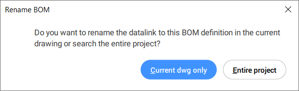

  • Rename file: opens the Rename drawing dialog box that allows you to rename the Master model. All related are automatically renamed as well.
