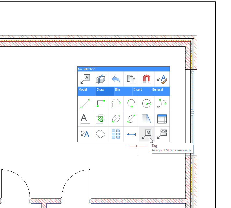

  2. With no selection, select Tag from the Quad or enter BIMTAG followed by M into the Command line to choose the manual option.
    You are prompted: Pick point on a sectioned BIM element [Auto/Current mleader style/change Tag type]:

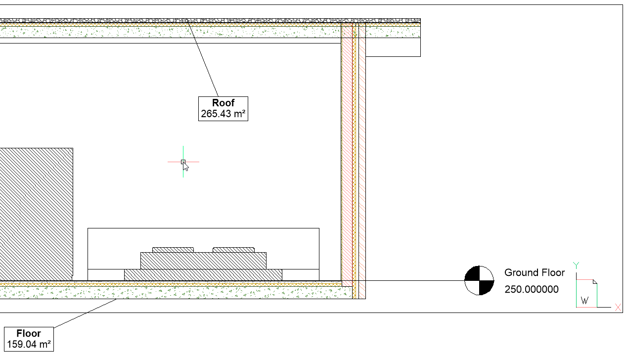

    The same steps above can be used to tag a floor slab or a roof.

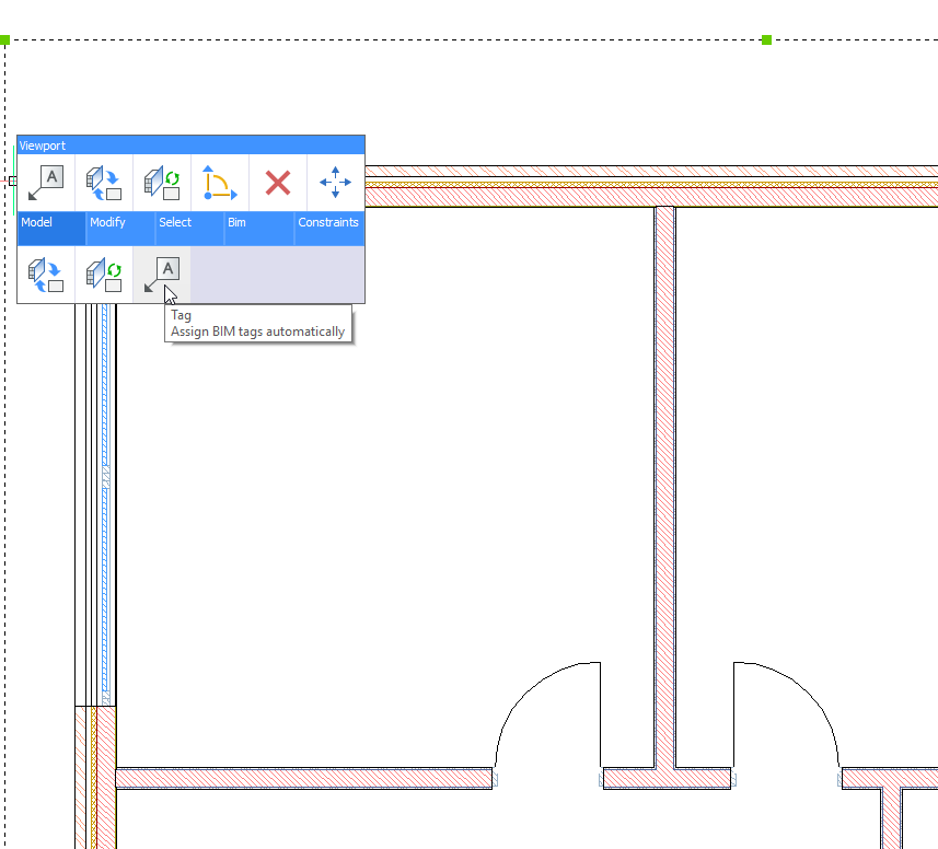

Assign BIM tags automatically
If you want all BIM elements in a section drawing to be tagged, it is better to use the Auto option of the BIMTAG command. This command option automatically assigns BIM tags to all BIM entities inside a viewport. If the model is edited or new elements are added, the BIM tags can be updated and new tags added.
For more information about this option, visit the Command reference article BIMTAG command.
Automatically create BIM tags
  1. Open the section drawing for which you want to create BIM tags.
  2. Select a viewport containing the section you want to add BIM tags to.
  3. Select Tag from the Quad or enter BIMTAG in the Command line.
    As section indicators, story indicators and grid callouts are generated automatically within section update, it means tags already have been assigned to the section, you will be prompted:
    Tags already have been assigned to the section. Choose an update option [Update existing/update existing and add New/Regenerate all] <Regenerate all>:
    With the update existing and add New option, the BIM tags have automatically been generated for each of the BIM entities in the viewport.
    You are prompted: Select BIM section viewport [Manual/Box selection/selection options (?)]:
  4. If you wish to automatically create BIM tags in another viewport on the sheet, select the viewport. If you do not require any further BIM tags, press Esc to complete the command.

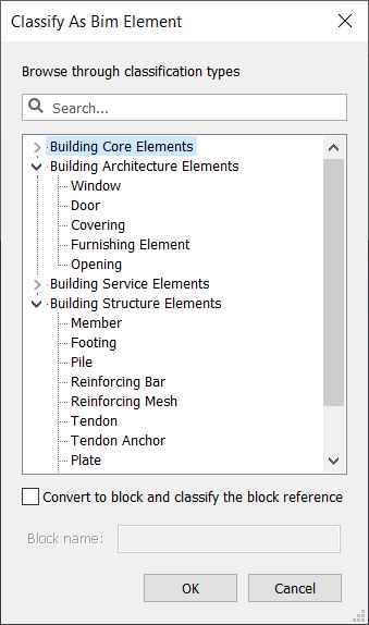

Create the source data for a BIM entity type
By default the source data for the following BIM entity types already exist; Annotation, Beam, Column, Curtain Wall, Door, Plies, Railing, Ramp, Roof, Room, Slab, Stair, Wall, Window, and Detail references.
Available BIM entity types are listed in the Classify As Bim Element dialog box. To open this dialog box, choose the Other option of the BIMCLASSIFY command.

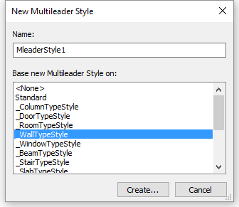

  9. Select Multileader Styles in the Drawing Explorer dialog box.
  10. Click the New () tool button.
    The New Multileader Style dialog box displays:
  11. In the Name field, type _MemberTypeStyle.
  12. Select a source style in the Base new Multileader Style on list.
  13. Click the Create... button.

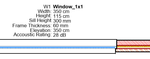

Customize tag blocks
The content of a BIM Tag block consists of:
  • Layout entities Linework, fixed texts, etc.
  • Attributes BIM entity properties.

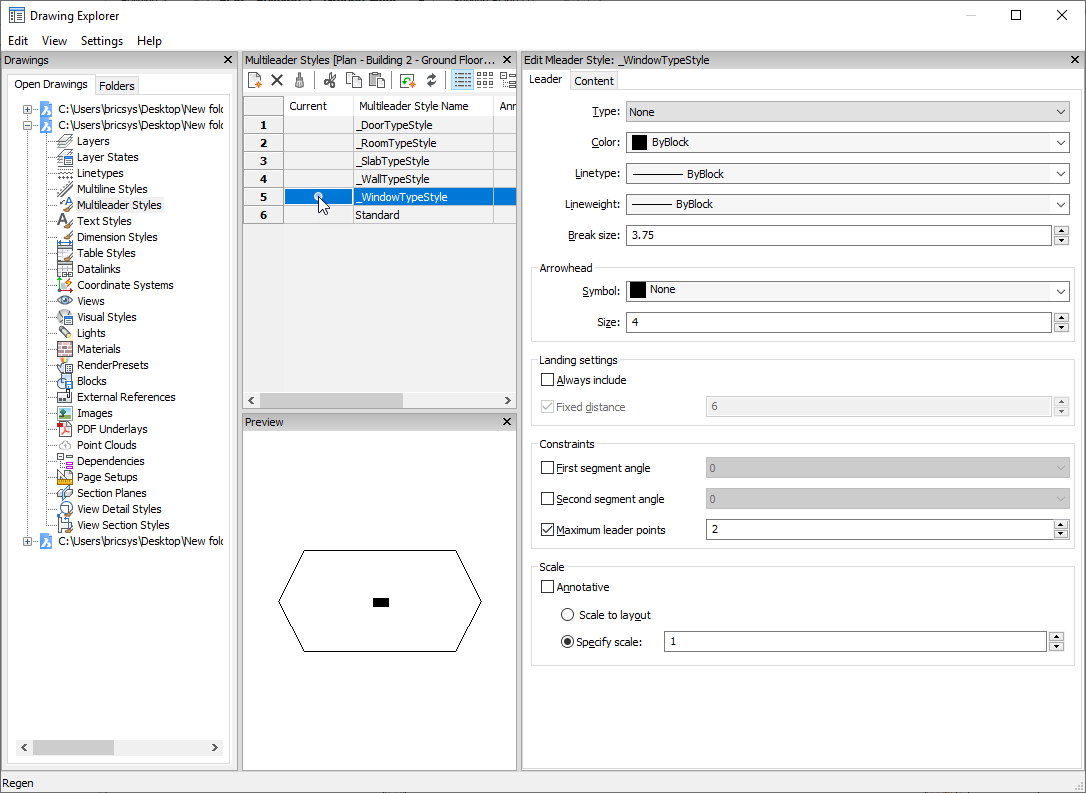

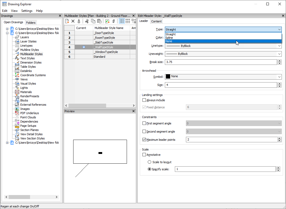

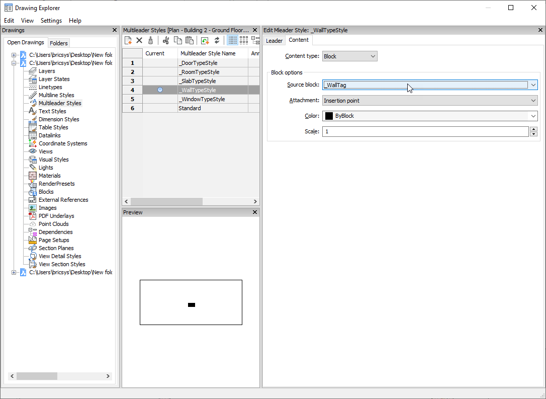

  1. In the section drawing for which you wish to customize the BIM tags, type MLEADERSTYLE in the Command line. The Drawing Explorer will open in the Multileader Styles tab.
    Each BIM tag is a multileader. The multileader style depends on the type of BIM element being tagged. All the multileader styles in the drawing are listed in the Drawing Explorer.
  2. Select _WallTypeStyle from the list to see a preview of the tag. You can change the tag style from here.
  3. Change the Leader Type from Straight to None. Now there will be no line connecting the tag to the wall element.

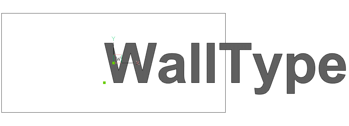

  4. In the Content tab, the Source block is called _WallTag. Remember this and close the Drawing Explorer.

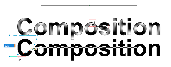

  5. In the Command line, type BEDIT and select _WallTag from the list. Click OK.

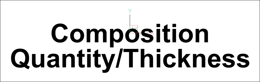

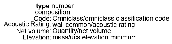

  6. Select the WallType text and Tag value of the Properties panel.
  7. Replace WallType with Composition and press ENTER (see the next procedure for the syntax of other property types). The attribute text will display Composition.
  8. Hover over this attribute and select Copy from the Quad. Select a base point to paste the copied attribute below the current one.
  9. Select the copied attribute and replace Composition with Quantity/Thickness in the Tag field from the Properties panel.
  10. Delete the rectangle.
    The two attributes will be displayed as in the following illustration:

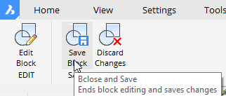

  11. Select the Save Block icon from the Block Editor tab of the ribbon, or type BCLOSE in the Command line and select the Save option.

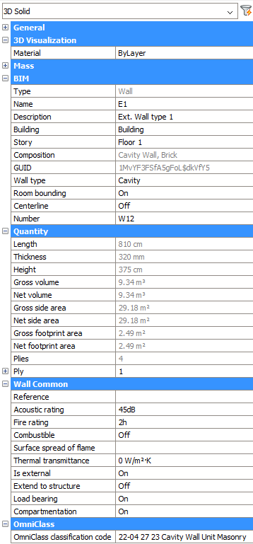

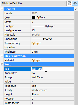

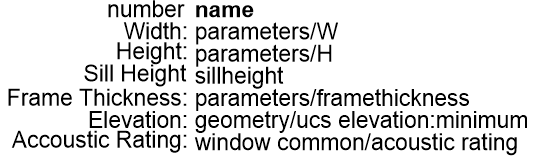

  5. Add attributes using the following syntax, in the Tag field, in the Properties panel:
    Property type Syntax Examples
    BIM <property name>
    name
    room bounding
    Parameters parameters/<parametername>
    parameters/w
    parameters/framethickness
    General general/<property name>
    general/layer
    general/linetype scale
    Mass
    mass/<property name>
    mass/<property name>:<child>
    mass/surface area
    mass/ucs elevation:minimum
    Geometry
    geometry/<property name>
    geometry/<property name>:<child>
    geometry/position
    geometry/ucs elevation:maximum
    Quantity quantity/<property name>
    quantity/length
    quantity/net footprint area
    IFC <ifc property set>/<ifc property>
    wall common/load bearing
    door window glazing type/glass layers
    User Defined <property set label>/<property label> exterior walls/price
    Classification system
    <classification system label>/
    <classification code label>
    omniclass/omniclass classification code
    Note: To know which properties are available for a specific BIM entity type, select the entity in the model and open the Properties panel.
    In the image below, the properties of a BIM Wall entity are listed.
    Click the + button to expand a property type node.

      Note: Do not double click the attribute. The Edit Attribute Definition dialog box does not accept spaces in the Tag field.
    • In the Properties panel, type the property reference in the Tag field (see the syntax in the above table).
    • (Optional) Define the Text properties (Text Style, Justify, Height, …) in the Properties panel.

  7. On the Block Edit toolbar, click the Save icon to conclude the BEDIT command, or type BCLOSE in the Command line, Save option.

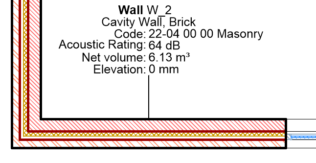

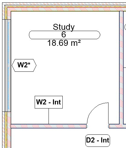

    Definitions in the tag block Resulting tag
    _WallTag block Wall tag in a plan section
    WindowTag block Window tag in a plan section

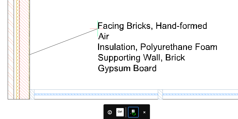

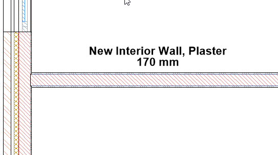

Assign composition tags
Composition tags allow you to tag a wall or a slab element in order to specify its composition. These BIM tags are a list of the ply materials which make up the element.
Create composition tags

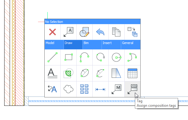

  1. Open the section drawing for which you wish to create composition tags.
  2. Select Tag Assign composition tags from the Quad.
    Or type BIMTAG in the Command line, then do one of the following:
    • Type M + Enter for the Manual option; then T + Enter for the change Tag type, followed by O + Enter for the cOmposition option.
    • Click the options in the Command line.
    • Click the options in the Prompt Menu.
  3. You are prompted: Pick point on a sectioned BIM element [Auto/Current mleader style/change Tag type]:
    Select a point on a BIM element to generate a tag for it. The tag will appear. If the selected point is shared between multiple BIM entities, you can use the Ctrl key to cycle through the different possible composition tags.
    You are prompted: Place the tag [Next element]:
  4. To adjust the position of the tag, move the cursor and left click to place it.
  5. Repeat steps 3 and 4 for all of the entities you wish to be tagged. If you do not require any more tags, press the Esc or Enter to complete the command.
