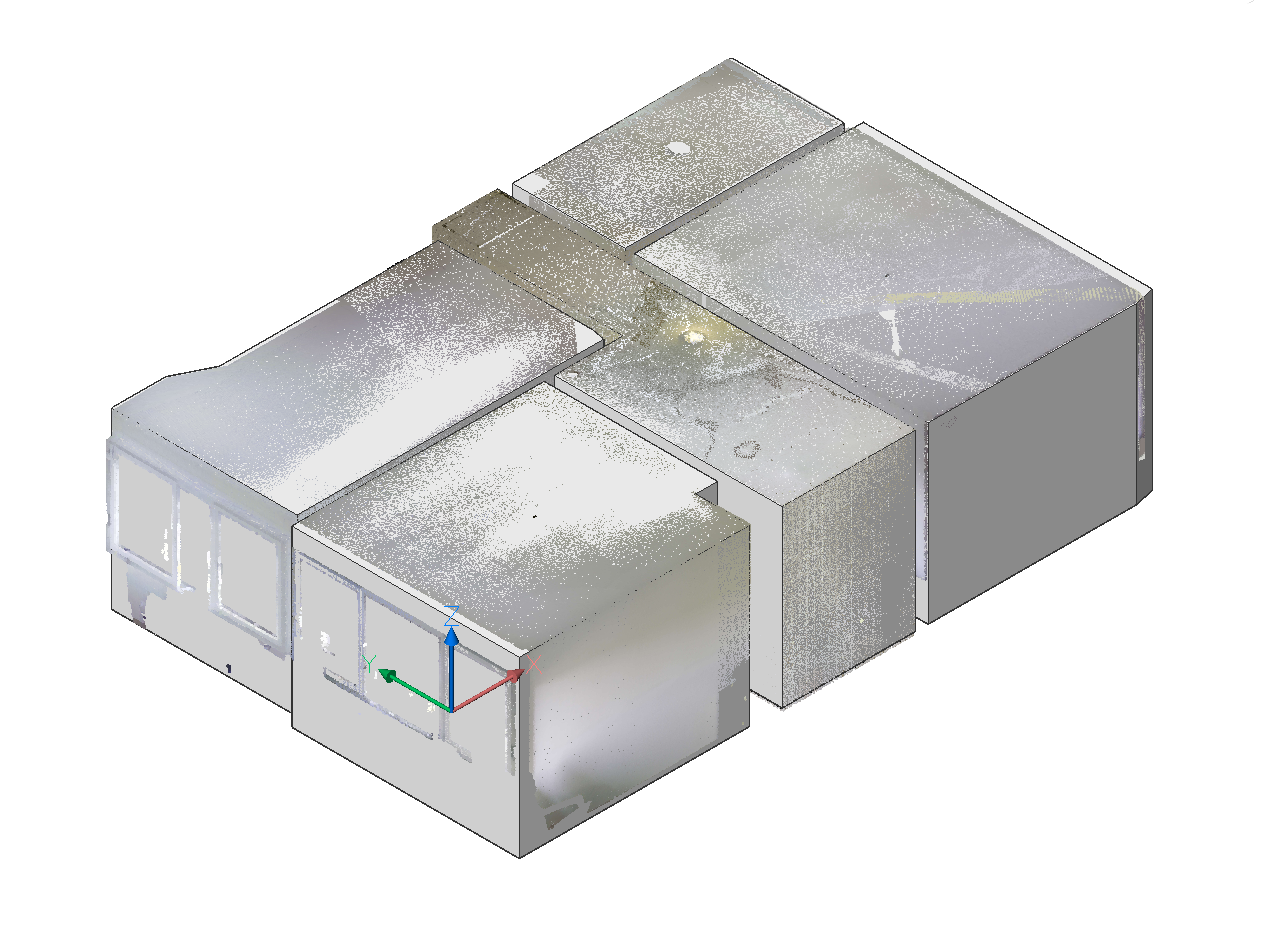

Once the points in the selection have been classified into different rooms, you can create solids based on this classification.

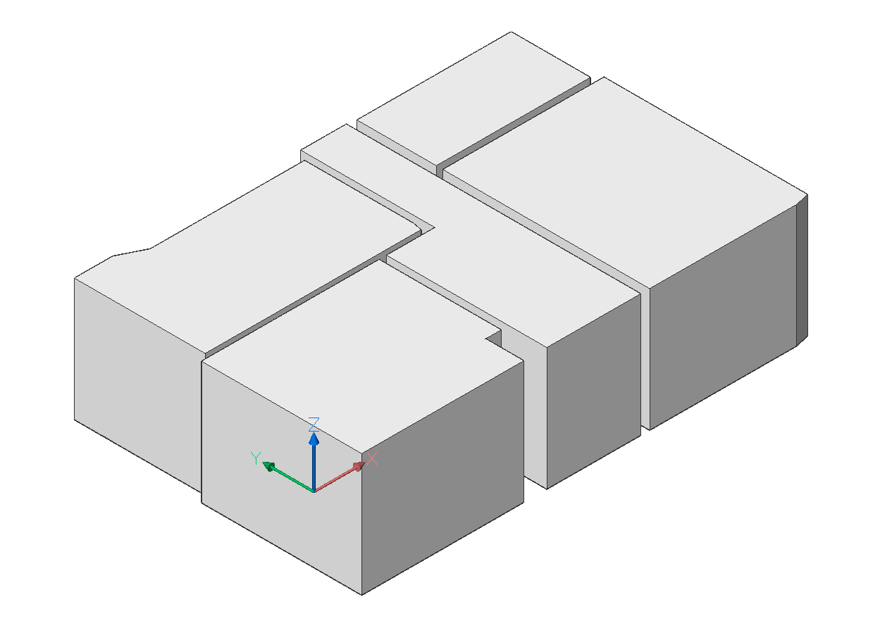

Creating room solids
The third step of the Scan to BIM workflow is to create room solids based on the detected rooms.
- Launch the POINTCLOUDFITROOMS command.
You are prompted: Specify building Id or select all.
- Do one of the following:
- Click All to create solids for all the detected rooms.
- Click Id to create a solid for the detected room with the specified Id.
You are prompted: Restrict detection to perpendicular (90°) walls?
- Select Yes if the rooms have two perpendicular wall directions.
The command starts the background processing. Depending on the point cloud size and wall directions, this can take up to several minutes.
Note: You can continue working during the background processing.When the background processing finishes, a pop-up message appears. The created solids are assigned to the automatically generated Rooms layer.
- Turn off the attached point cloud's visibility. The rooms solids are now visible.
Optionally, you can edit the rooms by using the DMPUSHPULL command to adjust the faces of the created solids.

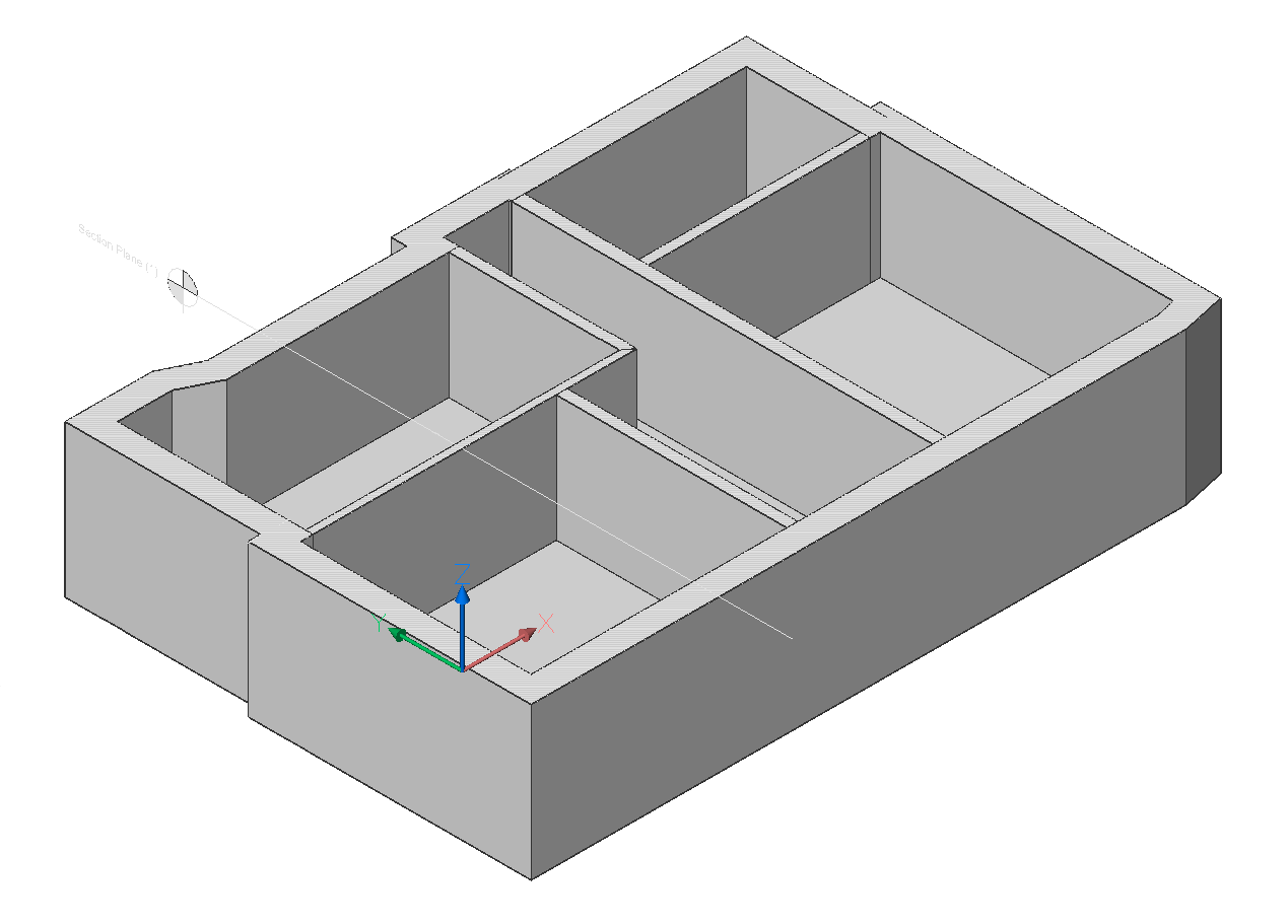

Creating BIM components
The last step of the Scan to BIM workflow is to generate walls in between the previously created solids, as well as the outer shell.
- Select a layer on which the BIM components will be created.
- Launch the BIMINVERTSPACES command. The Invert Spaces Command Context panel opens to let you define the settings. For detailed information about each option, see the article BIMINVERTSPACES command.
- Click Apply.
The Scan to BIM workflow is now complete, with the 3D model based on the point cloud being fully generated.
- Turn off the layer on which the room solids were created.
- Use the BIMSECTION command to create a horizontal section plane that displays the internal walls.
- Use wall editing tools like the LCONNECT or BIMEXTEND commands to adjust the result as needed.
